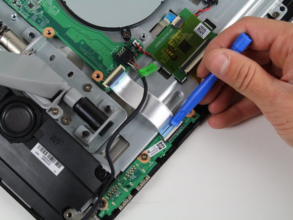

  10. HP ENVY Rove 20-k014us USB Board Replacement, USB Board: crwdns2935265:010crwdnd2935265:01crwdnd2935265:02crwdne2935265:0 HP ENVY Rove 20-k014us USB Board Replacement, USB Board: crwdns2935265:010crwdnd2935265:02crwdnd2935265:02crwdne2935265:0
    • Flip up the white plastic that holds the cable connection using the plastic opening tool.
  11. HP ENVY Rove 20-k014us USB Board Replacement: crwdns2935265:011crwdnd2935265:01crwdnd2935265:01crwdne2935265:0
    • Gently pull out the cable connection.
    • When you insert the cable connection back in, make sure the component is securely fastened.
  12. HP ENVY Rove 20-k014us USB Board Replacement: crwdns2935265:012crwdnd2935265:01crwdnd2935265:01crwdne2935265:0
    • Remove two 6.35 mm PH#0 screws around the board.
  13. HP ENVY Rove 20-k014us USB Board Replacement: crwdns2935265:013crwdnd2935265:01crwdnd2935265:01crwdne2935265:0
    • Remove the board.
