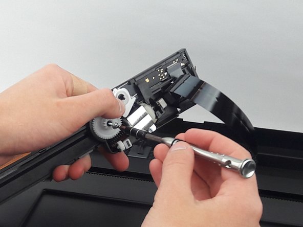

  7. HP ENVY 5530 Gear for Scanner Arm Replacement: crwdns2935265:07crwdnd2935265:01crwdnd2935265:02crwdne2935265:0 HP ENVY 5530 Gear for Scanner Arm Replacement: crwdns2935265:07crwdnd2935265:02crwdnd2935265:02crwdne2935265:0
    • Unscrew and remove the 13mm TR10 Torx Security screw in the center of the gear using the iFixit screwdriver

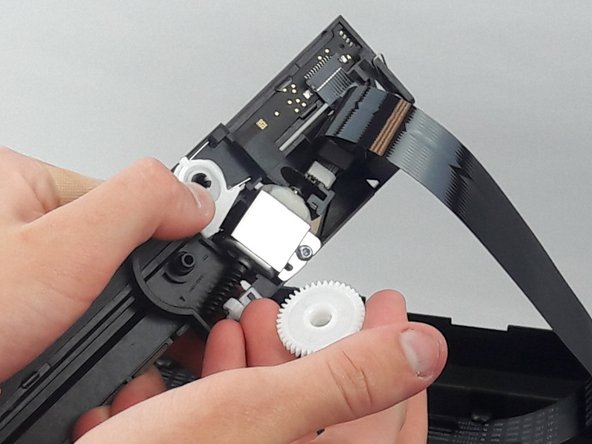

  8. HP ENVY 5530 Gear for Scanner Arm Replacement: crwdns2935265:08crwdnd2935265:01crwdnd2935265:03crwdne2935265:0 HP ENVY 5530 Gear for Scanner Arm Replacement: crwdns2935265:08crwdnd2935265:02crwdnd2935265:03crwdne2935265:0 HP ENVY 5530 Gear for Scanner Arm Replacement: crwdns2935265:08crwdnd2935265:03crwdnd2935265:03crwdne2935265:0
    • Locate the white gear and remove.

It is not possible to get to the bottom two screws out without tilting the scan bed/cover back more. To that, I had to disconnect the swing arm on the right side of the scanner bed/cover. After that, all worked smoothly. Thank you.
