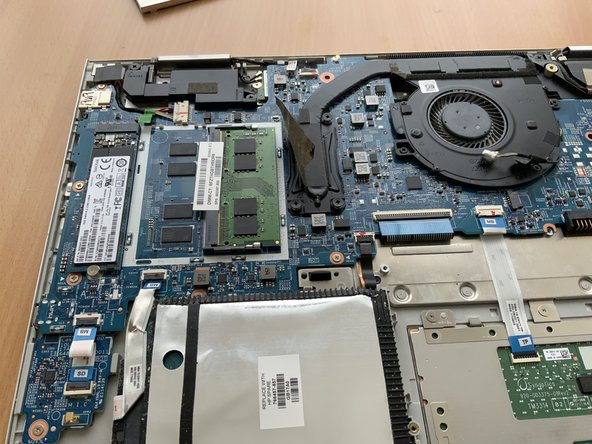

  8. HP ENVY ×360 15-bp106ng RAM Replacement, Remove tape from RAM housing: crwdns2935265:08crwdnd2935265:01crwdnd2935265:01crwdne2935265:0
    • Remove the black tape that is stuck to the large silver-black RAM housing.

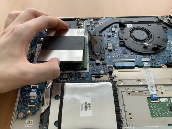

  9. HP ENVY ×360 15-bp106ng RAM Replacement, Remove RAM housing: crwdns2935265:09crwdnd2935265:01crwdnd2935265:03crwdne2935265:0 HP ENVY ×360 15-bp106ng RAM Replacement, Remove RAM housing: crwdns2935265:09crwdnd2935265:02crwdnd2935265:03crwdne2935265:0 HP ENVY ×360 15-bp106ng RAM Replacement, Remove RAM housing: crwdns2935265:09crwdnd2935265:03crwdnd2935265:03crwdne2935265:0
    • Using a spudger, gently separate the RAM housing from the main board.

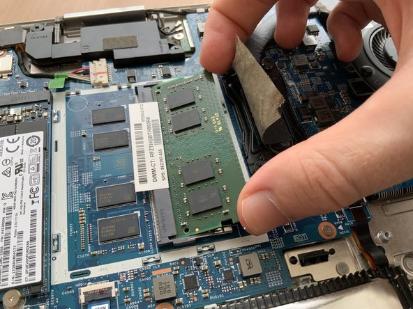

  10. HP ENVY ×360 15-bp106ng RAM Replacement, Remove RAM: crwdns2935265:010crwdnd2935265:01crwdnd2935265:02crwdne2935265:0 HP ENVY ×360 15-bp106ng RAM Replacement, Remove RAM: crwdns2935265:010crwdnd2935265:02crwdnd2935265:02crwdne2935265:0
    • Using both hands, bend outwards the two clips that hold the RAM module.
    • Remove the RAM module to the right and up.
    • Now insert the new RAM module, pushing it in from the right.
