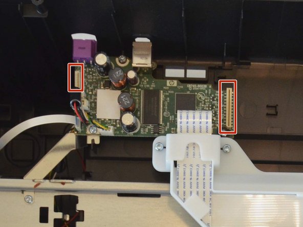

  5. HP Deskjet F4480 Top Lid Replacement: crwdns2935265:05crwdnd2935265:01crwdnd2935265:03crwdne2935265:0 HP Deskjet F4480 Top Lid Replacement: crwdns2935265:05crwdnd2935265:02crwdnd2935265:03crwdne2935265:0 HP Deskjet F4480 Top Lid Replacement: crwdns2935265:05crwdnd2935265:03crwdnd2935265:03crwdne2935265:0
    • Remove the two cables by gripping each one close to their connection ports on the motherboard and gently disconnecting them.
