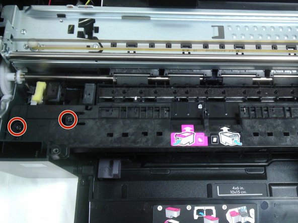

    • Remove the two 9mm Torx screws on either side of the white bracket.
  7. HP Deskjet F4480 Paper Roller Motor Replacement: crwdns2935265:07crwdnd2935265:01crwdnd2935265:02crwdne2935265:0 HP Deskjet F4480 Paper Roller Motor Replacement: crwdns2935265:07crwdnd2935265:02crwdnd2935265:02crwdne2935265:0
