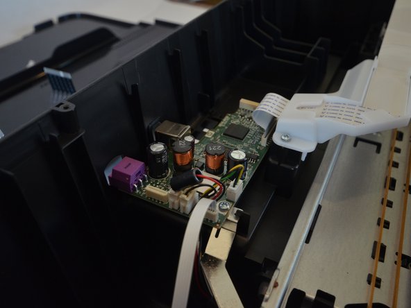

  5. HP Deskjet F4480 Mother Board Replacement: crwdns2935265:05crwdnd2935265:01crwdnd2935265:03crwdne2935265:0 HP Deskjet F4480 Mother Board Replacement: crwdns2935265:05crwdnd2935265:02crwdnd2935265:03crwdne2935265:0 HP Deskjet F4480 Mother Board Replacement: crwdns2935265:05crwdnd2935265:03crwdnd2935265:03crwdne2935265:0
    • Remove the two cables by gripping each one close to their connection ports on the motherboard and gently disconnecting them.
  6. HP Deskjet F4480 Mother Board Replacement, Mother Board: crwdns2935265:06crwdnd2935265:01crwdnd2935265:02crwdne2935265:0 HP Deskjet F4480 Mother Board Replacement, Mother Board: crwdns2935265:06crwdnd2935265:02crwdnd2935265:02crwdne2935265:0
    • The mother board is located at the back of the printer.
  7. HP Deskjet F4480 Mother Board Replacement: crwdns2935265:07crwdnd2935265:01crwdnd2935265:03crwdne2935265:0 HP Deskjet F4480 Mother Board Replacement: crwdns2935265:07crwdnd2935265:02crwdnd2935265:03crwdne2935265:0 HP Deskjet F4480 Mother Board Replacement: crwdns2935265:07crwdnd2935265:03crwdnd2935265:03crwdne2935265:0
    • Take note of the wire's location and orientation as this will be important to properly reassemble your device.
    • Remove all of the wires connected to the mother board. There are seven in total.

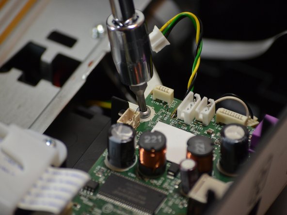

  8. HP Deskjet F4480 Mother Board Replacement: crwdns2935265:08crwdnd2935265:01crwdnd2935265:02crwdne2935265:0 HP Deskjet F4480 Mother Board Replacement: crwdns2935265:08crwdnd2935265:02crwdnd2935265:02crwdne2935265:0
    • Remove the three 9mm T10 Torx screws that hold the motherboard to the body of the printer
  9. HP Deskjet F4480 Mother Board Replacement: crwdns2935265:09crwdnd2935265:01crwdnd2935265:01crwdne2935265:0
    • At this point, the mother board should be free of all connections from the rest of the printer.
    • Remove and replace the mother board with the new one.
