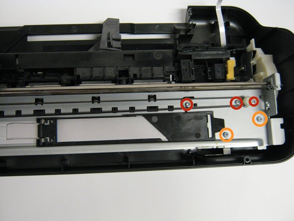

  5. HP Deskjet D1660 Rollers Replacement, Rollers: crwdns2935265:05crwdnd2935265:01crwdnd2935265:02crwdne2935265:0 HP Deskjet D1660 Rollers Replacement, Rollers: crwdns2935265:05crwdnd2935265:02crwdnd2935265:02crwdne2935265:0
    • Remove the five 13.0 mm Torx #10 screws found on top of the frame.
    • Remove the four 9.0 mm Torx #10 smaller screws.

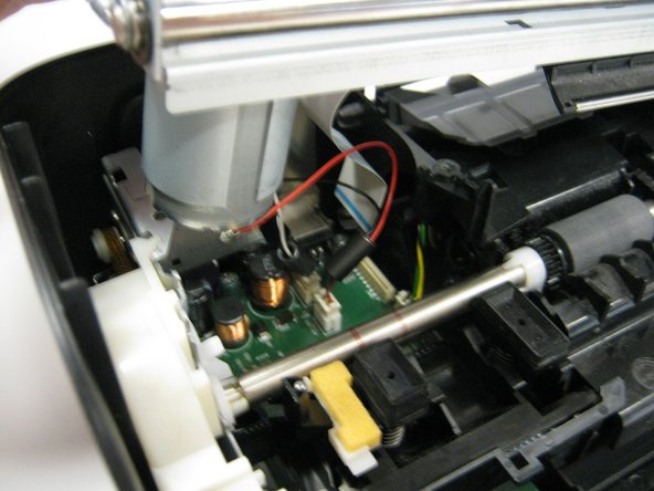

  6. HP Deskjet D1660 Rollers Replacement: crwdns2935265:06crwdnd2935265:01crwdnd2935265:02crwdne2935265:0 HP Deskjet D1660 Rollers Replacement: crwdns2935265:06crwdnd2935265:02crwdnd2935265:02crwdne2935265:0
    • Lift the cover up using both of your hands.
    • Lift it carefully as a strip and motor will be connected to the bottom part of the printer.
  7. HP Deskjet D1660 Rollers Replacement: crwdns2935265:07crwdnd2935265:01crwdnd2935265:02crwdne2935265:0 HP Deskjet D1660 Rollers Replacement: crwdns2935265:07crwdnd2935265:02crwdnd2935265:02crwdne2935265:0
    • Locate the rollers, which will be on the bottom of the metal frame that holds the carriage.
    • Grab the rollers and remove them by pulling them to one side and lifting them up.
    • Do the same for the other three.
