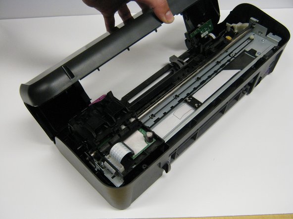

    4. HP Deskjet D1660 Power Button Replacement: crwdns2935265:04crwdnd2935265:01crwdnd2935265:03crwdne2935265:0 HP Deskjet D1660 Power Button Replacement: crwdns2935265:04crwdnd2935265:02crwdnd2935265:03crwdne2935265:0 HP Deskjet D1660 Power Button Replacement: crwdns2935265:04crwdnd2935265:03crwdnd2935265:03crwdne2935265:0
      • Take out the two frontal 14.0 mm Torx #10 screws.
      • Carefully lift the frontal cover.
      • Don't lift it up aggressively. A strip will be attached to it.

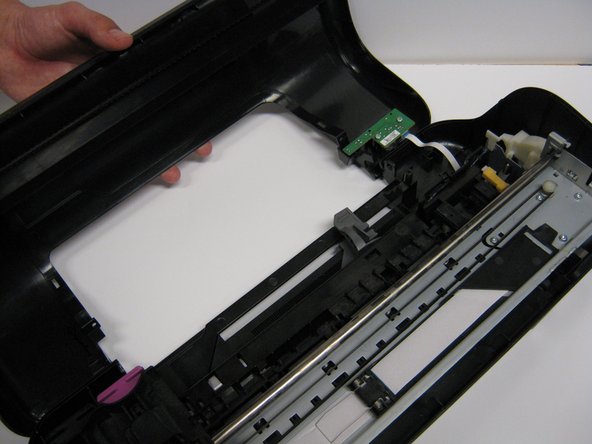

    1. HP Deskjet D1660 Power Button Replacement, Power Button: crwdns2935265:05crwdnd2935265:01crwdnd2935265:01crwdne2935265:0
      • Remove the strip that connects the printer to the front cover.
    2. HP Deskjet D1660 Power Button Replacement: crwdns2935265:06crwdnd2935265:01crwdnd2935265:02crwdne2935265:0 HP Deskjet D1660 Power Button Replacement: crwdns2935265:06crwdnd2935265:02crwdnd2935265:02crwdne2935265:0
      • Remove the two 13.0 mm Torx #10 screws.
      • Carefully lift it up. The button will be located under it.

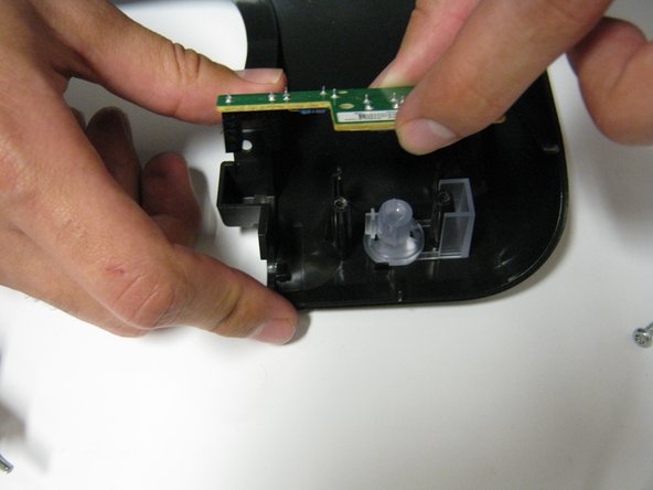

    3. HP Deskjet D1660 Power Button Replacement: crwdns2935265:07crwdnd2935265:01crwdnd2935265:01crwdne2935265:0
      • Lift up the power button.
