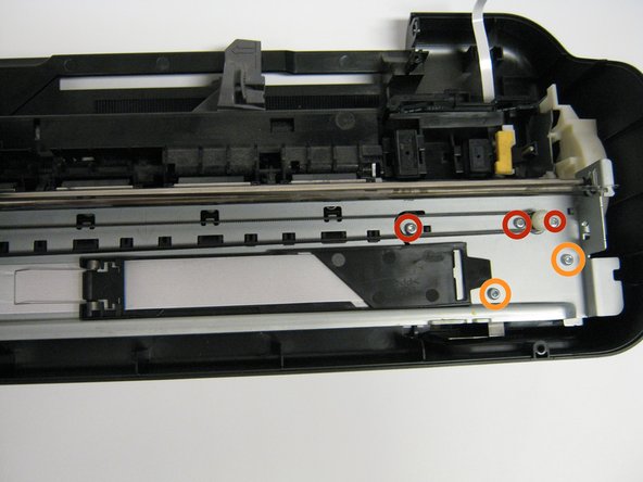

  5. HP Deskjet D1660 Gear Guard Replacement, Ink Cartridge Rail: crwdns2935265:05crwdnd2935265:01crwdnd2935265:02crwdne2935265:0 HP Deskjet D1660 Gear Guard Replacement, Ink Cartridge Rail: crwdns2935265:05crwdnd2935265:02crwdnd2935265:02crwdne2935265:0
    • Remove the five 13.0 mm Torx #10 screws found on top of the frame.
    • Remove the four 9.0 mm Torx #10 smaller screws.
  6. HP Deskjet D1660 Gear Guard Replacement: crwdns2935265:06crwdnd2935265:01crwdnd2935265:02crwdne2935265:0 HP Deskjet D1660 Gear Guard Replacement: crwdns2935265:06crwdnd2935265:02crwdnd2935265:02crwdne2935265:0
    • Lift the rail carefully as a strip and motor will be connected to the bottom part of the printer.
    • Now detach the white strip and wires by gently lifting them up.
  7. HP Deskjet D1660 Gear Guard Replacement, Gear Guard: crwdns2935265:07crwdnd2935265:01crwdnd2935265:01crwdne2935265:0
    • The gear guard will be located on the left side of the printer.
    • Grab the plastic guard and lift it up.
