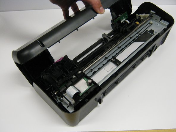

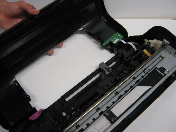

      • Take out the two frontal 14.0 mm Torx #10 screws.
      • Carefully lift the frontal cover.
      • Don't lift it up aggressively. A strip will be attached to it.

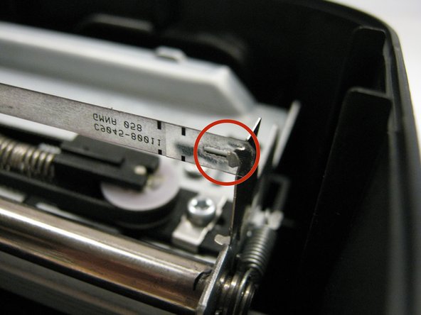

      • Looking at the printer from the front, carefully unhook the encoder strip from the left side.
      • Pull the strip to the left and push a little to unhook the strip.
      • Do the same thing on the other side by pulling to the right and pushing a little.
      • Pull the strip completely out from the cartridge holder.
