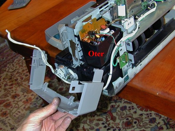

  6. HP Deskjet 930c Disassembly to clean Waste Ink Reservoir: crwdns2935265:06crwdnd2935265:01crwdnd2935265:03crwdne2935265:0 HP Deskjet 930c Disassembly to clean Waste Ink Reservoir: crwdns2935265:06crwdnd2935265:02crwdnd2935265:03crwdne2935265:0 HP Deskjet 930c Disassembly to clean Waste Ink Reservoir: crwdns2935265:06crwdnd2935265:03crwdnd2935265:03crwdne2935265:0
    • Remove the plastic piece covering the motor that controls the waste ink assembly.
    • Disconnect the motor connection.

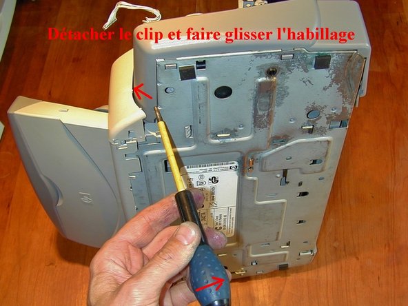

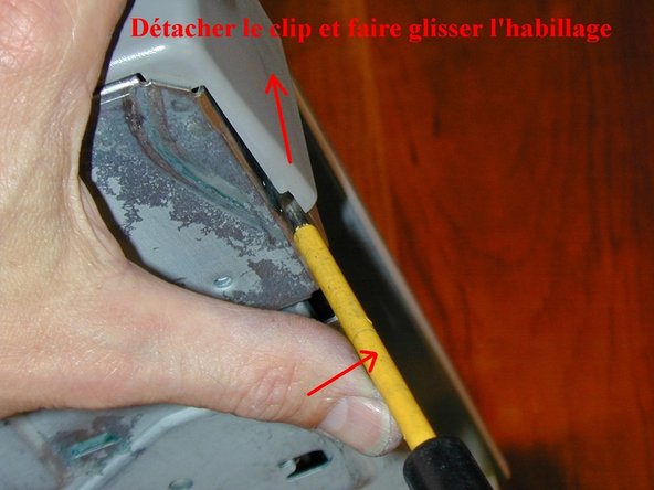

  8. HP Deskjet 930c Disassembly to clean Waste Ink Reservoir: crwdns2935265:08crwdnd2935265:01crwdnd2935265:03crwdne2935265:0 HP Deskjet 930c Disassembly to clean Waste Ink Reservoir: crwdns2935265:08crwdnd2935265:02crwdnd2935265:03crwdne2935265:0 HP Deskjet 930c Disassembly to clean Waste Ink Reservoir: crwdns2935265:08crwdnd2935265:03crwdnd2935265:03crwdne2935265:0
    • Press the clip marked in red.
    • Slide it to the right.
    • Lift and remove this side.
  9. HP Deskjet 930c Disassembly to clean Waste Ink Reservoir: crwdns2935265:09crwdnd2935265:01crwdnd2935265:02crwdne2935265:0 HP Deskjet 930c Disassembly to clean Waste Ink Reservoir: crwdns2935265:09crwdnd2935265:02crwdnd2935265:02crwdne2935265:0
    • Press where marked with the arrow and lift the waste ink reservoir.
    • Remove the motor and clean with high-pressured water.
