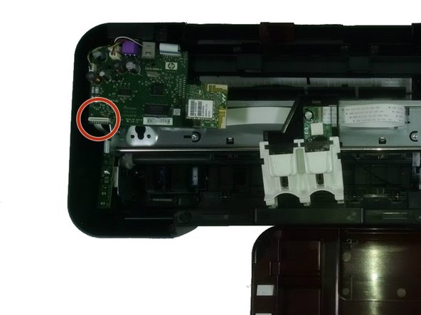

  7. HP Deskjet 3000 j310a Repair Printer Cover Replacement, Disconnect Cover: crwdns2935265:07crwdnd2935265:01crwdnd2935265:02crwdne2935265:0 HP Deskjet 3000 j310a Repair Printer Cover Replacement, Disconnect Cover: crwdns2935265:07crwdnd2935265:02crwdnd2935265:02crwdne2935265:0
    • Once the top is loose, there will still be a connection wire between the printer and the cover. This wire will be about one inch wide and white, located under the buttons.
  8. HP Deskjet 3000 j310a Repair Printer Cover Replacement: crwdns2935265:08crwdnd2935265:01crwdnd2935265:02crwdne2935265:0 HP Deskjet 3000 j310a Repair Printer Cover Replacement: crwdns2935265:08crwdnd2935265:02crwdnd2935265:02crwdne2935265:0
    • Detach the wire from the printer by pulling the blue-sealed end from the white holder.
