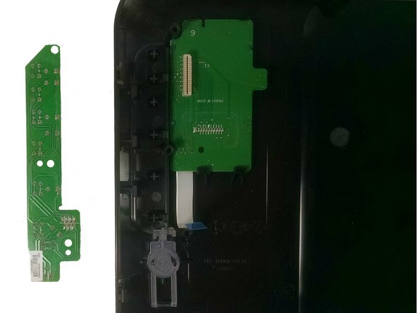

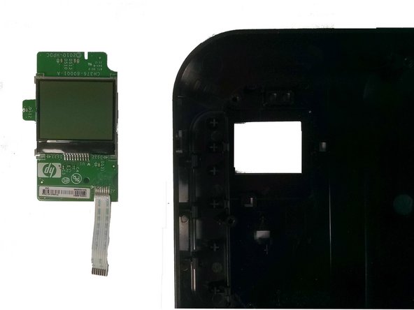

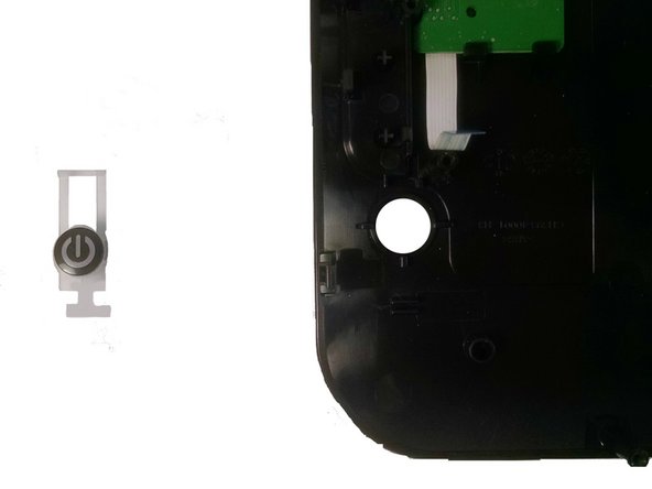

  11. HP Deskjet 3000 j310a Repair Control Panel Replacement: crwdns2935265:011crwdnd2935265:01crwdnd2935265:01crwdne2935265:0
    • You will need to remove the button, button circuit board, and screen in order to replace the control panel.
  12. HP Deskjet 3000 j310a Repair Control Panel Replacement: crwdns2935265:012crwdnd2935265:01crwdnd2935265:03crwdne2935265:0 HP Deskjet 3000 j310a Repair Control Panel Replacement: crwdns2935265:012crwdnd2935265:02crwdnd2935265:03crwdne2935265:0 HP Deskjet 3000 j310a Repair Control Panel Replacement: crwdns2935265:012crwdnd2935265:03crwdnd2935265:03crwdne2935265:0
    • Unscrew the three screws indicated in the image. Unplug the connection from the screen, lift up the board, and remove from the panel. Pull the button out.
  13. HP Deskjet 3000 j310a Repair Control Panel Replacement: crwdns2935265:013crwdnd2935265:01crwdnd2935265:02crwdne2935265:0 HP Deskjet 3000 j310a Repair Control Panel Replacement: crwdns2935265:013crwdnd2935265:02crwdnd2935265:02crwdne2935265:0
    • Using the plastic opening tool pry the black tabs back and lift the screen out of the control panel.
