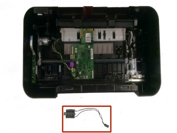

  25. HP Deskjet 3000 j310a Repair Carriage Drive Motor Replacement, Removing Carriage Drive Motor: crwdns2935265:025crwdnd2935265:01crwdnd2935265:01crwdne2935265:0
    • Remove the metal bar that the motor is attached to.
  26. HP Deskjet 3000 j310a Repair Carriage Drive Motor Replacement, Disconnecting Carriage Drive Motor: crwdns2935265:026crwdnd2935265:01crwdnd2935265:02crwdne2935265:0 HP Deskjet 3000 j310a Repair Carriage Drive Motor Replacement, Disconnecting Carriage Drive Motor: crwdns2935265:026crwdnd2935265:02crwdnd2935265:02crwdne2935265:0
    • Untwist the red and black wires that are connected to the motor from the other colored wires.
    • Disconnect the end of those two wires from the circuit board.
