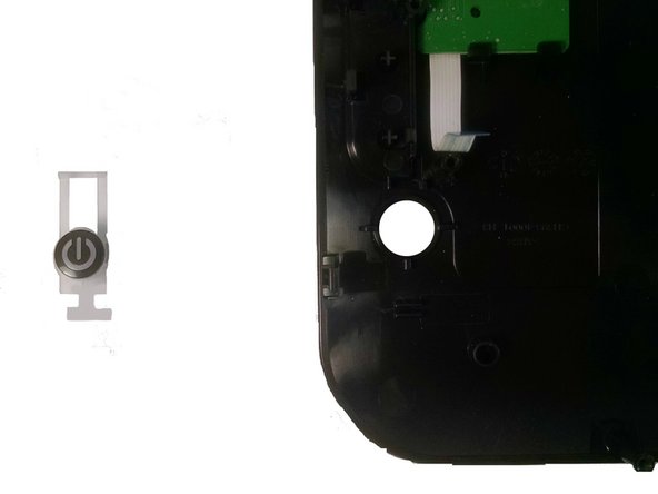

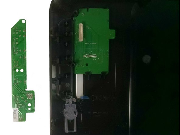

  11. HP Deskjet 3000 j310a Power Button Replacement: crwdns2935265:011crwdnd2935265:01crwdnd2935265:01crwdne2935265:0
    • You will need to remove the button, button circuit board, and screen in order to replace the control panel.
  12. HP Deskjet 3000 j310a Power Button Replacement: crwdns2935265:012crwdnd2935265:01crwdnd2935265:03crwdne2935265:0 HP Deskjet 3000 j310a Power Button Replacement: crwdns2935265:012crwdnd2935265:02crwdnd2935265:03crwdne2935265:0 HP Deskjet 3000 j310a Power Button Replacement: crwdns2935265:012crwdnd2935265:03crwdnd2935265:03crwdne2935265:0
    • Unscrew the three screws indicated in the image. Unplug the connection from the screen, lift up the board, and remove from the panel. Pull the button out.
