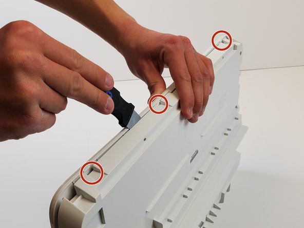

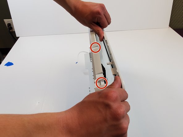

  5. HP Deskjet 2624 Scanner Glass Replacement: crwdns2935265:05crwdnd2935265:01crwdnd2935265:03crwdne2935265:0 HP Deskjet 2624 Scanner Glass Replacement: crwdns2935265:05crwdnd2935265:02crwdnd2935265:03crwdne2935265:0 HP Deskjet 2624 Scanner Glass Replacement: crwdns2935265:05crwdnd2935265:03crwdnd2935265:03crwdne2935265:0
    • Separate the plastic halves of the scanner bed by gently pulling the tabs on the clips holding the halves together.
    • Pull the halves apart while undoing the clips to prevent plastic snapping.
