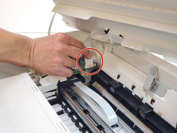

    • Gently lift the scanner bed module slightly off of the printer base. Be sure to carefully unplug the ribbon cables before fully removing the scanner bed.
    • Unplug the ribbon cables by pulling them gently straight out of their plugs.
  4. HP Deskjet 2624 Motherboard Replacement: crwdns2935265:04crwdnd2935265:01crwdnd2935265:01crwdne2935265:0
    • Remove the cables connected to the motherboard by gently pulling them straight out. Do not unplug the cables by pulling on the wires.
    • Unplug the last two ribbons connected to the motherboard by gently pulling them straight out.
    • Be sure to take note of where all plugs and ribbons are connected to the motherboard.
