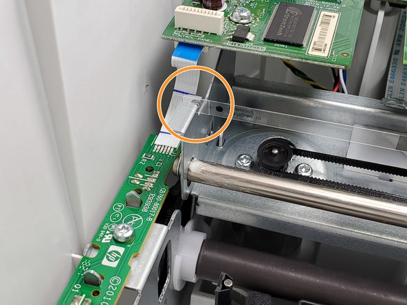

    • Locate the magnetic strip found running straight through the ink cartridge carriage.
  5. HP Deskjet 2624 Magnetic Strip Replacement: crwdns2935265:05crwdnd2935265:01crwdnd2935265:03crwdne2935265:0 HP Deskjet 2624 Magnetic Strip Replacement: crwdns2935265:05crwdnd2935265:02crwdnd2935265:03crwdne2935265:0 HP Deskjet 2624 Magnetic Strip Replacement: crwdns2935265:05crwdnd2935265:03crwdnd2935265:03crwdne2935265:0
    • To remove the strip, start by applying pressure to the silver connection located on the right hand side of the strip.
    • While applying pressure to the right hand side, push the strip off the left hand hook and pull it straight up.
    • Lift the strip vertically and unhook it from the silver strip.
    • When putting the strip back in, ensure that the arrow on the replacement faces to the right and downwards.
