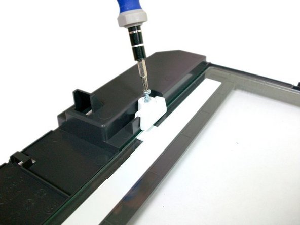

  6. HP Deskjet 1055 Scanner Glass Pane Replacement: crwdns2935265:06crwdnd2935265:01crwdnd2935265:02crwdne2935265:0 HP Deskjet 1055 Scanner Glass Pane Replacement: crwdns2935265:06crwdnd2935265:02crwdnd2935265:02crwdne2935265:0
    • Place the glass panel, face down, on a smooth surface.
    • Remove the 14 mm (1/2 in.) screw from the white plastic tab on the side of the panel with a T10 Torx screwdriver.

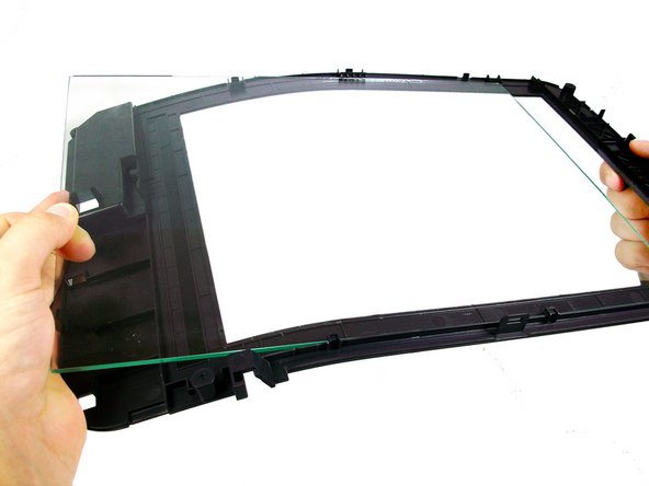

  7. HP Deskjet 1055 Scanner Glass Pane Replacement: crwdns2935265:07crwdnd2935265:01crwdnd2935265:03crwdne2935265:0 HP Deskjet 1055 Scanner Glass Pane Replacement: crwdns2935265:07crwdnd2935265:02crwdnd2935265:03crwdne2935265:0 HP Deskjet 1055 Scanner Glass Pane Replacement: crwdns2935265:07crwdnd2935265:03crwdnd2935265:03crwdne2935265:0
    • Remove the glass pane by carefully bending the plastic frame down from the side and sliding the glass pane out from the side.
