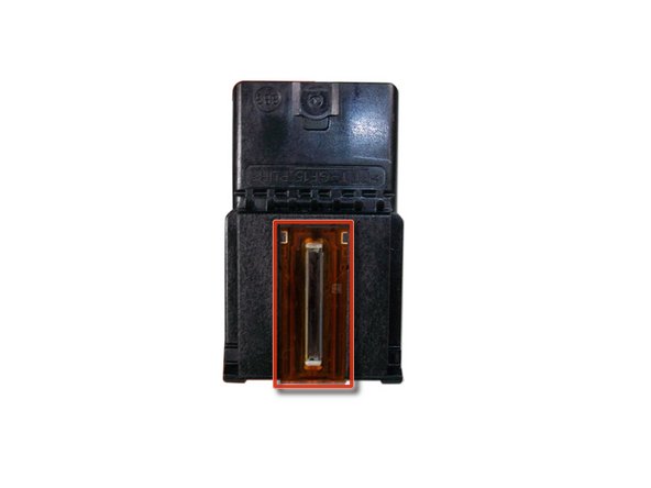

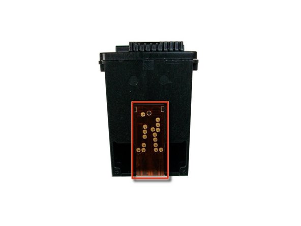

  4. HP Deskjet 1055 Ink Cartridge Replacement: crwdns2935265:04crwdnd2935265:01crwdnd2935265:03crwdne2935265:0 HP Deskjet 1055 Ink Cartridge Replacement: crwdns2935265:04crwdnd2935265:02crwdnd2935265:03crwdne2935265:0 HP Deskjet 1055 Ink Cartridge Replacement: crwdns2935265:04crwdnd2935265:03crwdnd2935265:03crwdne2935265:0
    • Take the replacement cartridge out of its packaging and pull off the plastic tab.
    • Do not touch the electrical contacts or ink nozzles. Touching may cause malfunctions.
    • Hold the cartridge on both sides with the title sticker facing upwards.

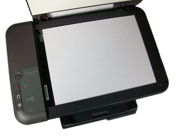

  7. HP Deskjet 1055 Ink Cartridge Replacement: crwdns2935265:07crwdnd2935265:01crwdnd2935265:02crwdne2935265:0 HP Deskjet 1055 Ink Cartridge Replacement: crwdns2935265:07crwdnd2935265:02crwdnd2935265:02crwdne2935265:0
    • Wait 30 seconds for the alignment page to print.
    • Open up the scanner lid and place the alignment page face-down in the right-front corner of the glass.
    • Close the lid.
  8. HP Deskjet 1055 Ink Cartridge Replacement: crwdns2935265:08crwdnd2935265:01crwdnd2935265:01crwdne2935265:0
    • Press the color copy button to begin scan.
    • Wait until the power button stops blinking.
When the power button stops blinking, your can now use your printer.
