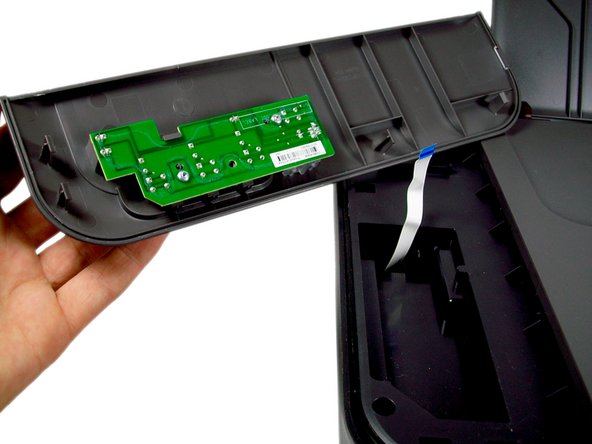

  3. HP Deskjet 1055 Buttons Replacement: crwdns2935265:03crwdnd2935265:01crwdnd2935265:03crwdne2935265:0 HP Deskjet 1055 Buttons Replacement: crwdns2935265:03crwdnd2935265:02crwdnd2935265:03crwdne2935265:0 HP Deskjet 1055 Buttons Replacement: crwdns2935265:03crwdnd2935265:03crwdnd2935265:03crwdne2935265:0
    • Turn the plate over to reveal the white strip of connecting tape that connects the plate to the printer.
    • Find where the tape is connected to the green button circuit board (Location circled in red)
    • Place two fingers on the tape right where it connects to the plate and gently pull the tape out of the circuit board.
  4. HP Deskjet 1055 Buttons Replacement: crwdns2935265:04crwdnd2935265:01crwdnd2935265:01crwdne2935265:0
    • Place the plate down on a flat surface with the button circuit board facing up.
    • Remove the three(3) T-10 Torx Screws from the circuit board.

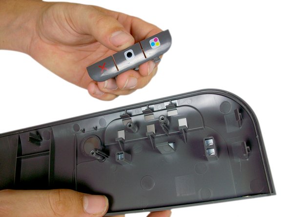

  6. HP Deskjet 1055 Buttons Replacement: crwdns2935265:06crwdnd2935265:01crwdnd2935265:02crwdne2935265:0 HP Deskjet 1055 Buttons Replacement: crwdns2935265:06crwdnd2935265:02crwdnd2935265:02crwdne2935265:0
    • After Removing the circuit board you will be able to see the backside of the set of function buttons.
    • Lightly push each of the six tabs away from the clips holding them in.
    • Make sure to unclip all the tabs before pushing the buttons out of the plate. All the buttons are connected as a set and trying to remove them one at a time will result in them breaking.
    • Once all of the tabs are loose from their clips, push the set of buttons down and out of the button plate.
  7. HP Deskjet 1055 Buttons Replacement: crwdns2935265:07crwdnd2935265:01crwdnd2935265:01crwdne2935265:0
    • The power button is not clipped in and should easily slide off of the plate once the button circuit board is removed.
