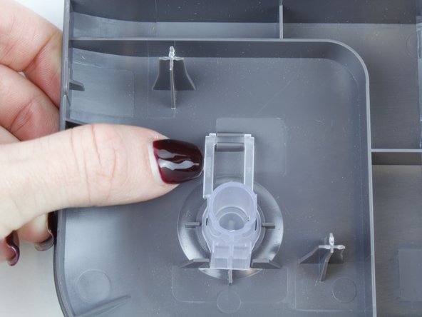

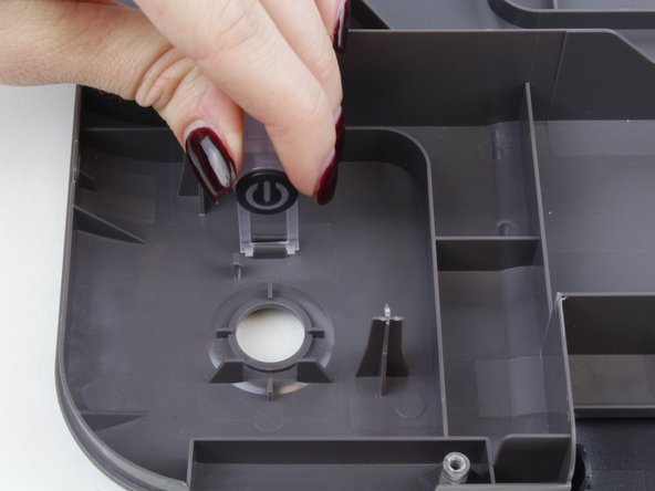

  4. HP Deskjet 1000 J110a Power Button Replacement, Power Button: crwdns2935265:04crwdnd2935265:01crwdnd2935265:03crwdne2935265:0 HP Deskjet 1000 J110a Power Button Replacement, Power Button: crwdns2935265:04crwdnd2935265:02crwdnd2935265:03crwdne2935265:0 HP Deskjet 1000 J110a Power Button Replacement, Power Button: crwdns2935265:04crwdnd2935265:03crwdnd2935265:03crwdne2935265:0
    • Carefully hold the small clip back to release the button arm.
    • Once the arm is unclipped, gently lift and pull the button until it disconnects at the hinge slot.
    • Replace the old power button with a new one.
