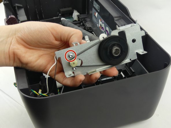

  12. HP Deskjet 1000 J110a Paper Roller Motor Replacement, Paper Roller Motor: crwdns2935265:012crwdnd2935265:01crwdnd2935265:01crwdne2935265:0
    • Remove the two 13mm screws which hold the paper roller motor frame in place.
  13. HP Deskjet 1000 J110a Paper Roller Motor Replacement: crwdns2935265:013crwdnd2935265:01crwdnd2935265:03crwdne2935265:0 HP Deskjet 1000 J110a Paper Roller Motor Replacement: crwdns2935265:013crwdnd2935265:02crwdnd2935265:03crwdne2935265:0 HP Deskjet 1000 J110a Paper Roller Motor Replacement: crwdns2935265:013crwdnd2935265:03crwdnd2935265:03crwdne2935265:0
    • Lift the roller arm and motor frame out enough to reach the belt and motor screws.
    • Unscrew the upper 4 mm screw which holds the motor in the metal frame. This allows the motor to slide enough to loosen the belt.
    • Remove the belt from the motor gear.
  14. HP Deskjet 1000 J110a Paper Roller Motor Replacement: crwdns2935265:014crwdnd2935265:01crwdnd2935265:02crwdne2935265:0 HP Deskjet 1000 J110a Paper Roller Motor Replacement: crwdns2935265:014crwdnd2935265:02crwdnd2935265:02crwdne2935265:0
    • Remove the remaining 4mm screw from the motor, then take the motor out.
