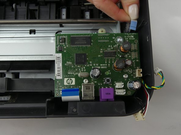

  6. HP Deskjet 1000 J110a Ink Carriage Motor Replacement: crwdns2935265:06crwdnd2935265:01crwdnd2935265:03crwdne2935265:0 HP Deskjet 1000 J110a Ink Carriage Motor Replacement: crwdns2935265:06crwdnd2935265:02crwdnd2935265:03crwdne2935265:0 HP Deskjet 1000 J110a Ink Carriage Motor Replacement: crwdns2935265:06crwdnd2935265:03crwdnd2935265:03crwdne2935265:0
    • Remove the top two 13mm screws using a screwdriver with the T10 torx bit.
    • Remove the bottom 9mm screw using a screwdriver with the T10 torx bit, and remove the plug port circuit board.

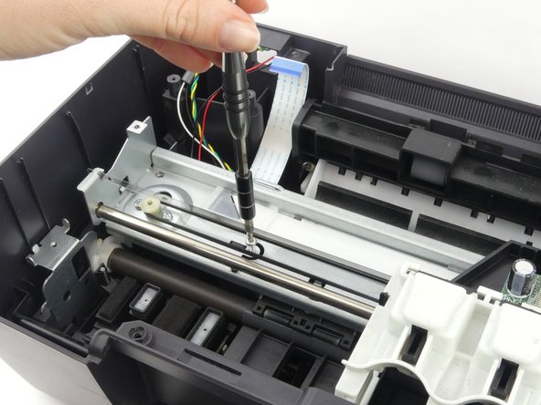

  7. HP Deskjet 1000 J110a Ink Carriage Motor Replacement, Ink Carriage Motor: crwdns2935265:07crwdnd2935265:01crwdnd2935265:02crwdne2935265:0 HP Deskjet 1000 J110a Ink Carriage Motor Replacement, Ink Carriage Motor: crwdns2935265:07crwdnd2935265:02crwdnd2935265:02crwdne2935265:0
    • Remove the two 13mm screws with the screwdriver and a T10 torx bit.
    • Slide the ink dispenser to the center in order to reach the screws.
    • Remove the one 9mm screw with the screwdriver and a T10 torx bit.

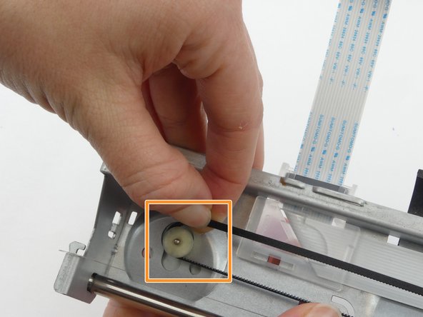

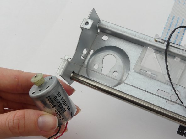

  9. HP Deskjet 1000 J110a Ink Carriage Motor Replacement: crwdns2935265:09crwdnd2935265:01crwdnd2935265:03crwdne2935265:0 HP Deskjet 1000 J110a Ink Carriage Motor Replacement: crwdns2935265:09crwdnd2935265:02crwdnd2935265:03crwdne2935265:0 HP Deskjet 1000 J110a Ink Carriage Motor Replacement: crwdns2935265:09crwdnd2935265:03crwdnd2935265:03crwdne2935265:0
    • Remove the two 5mm screws which hold motor in place.
    • Remove the belt from the round motor gear, then remove the ink carriage motor.
    • Be careful not to allow pulley on right side of belt to fall out and become lost. It will remain in place if the assembly is handled gently.
    • Ignore these instructions if you are replacing the paper roller motor instead of the ink carriage motor.
