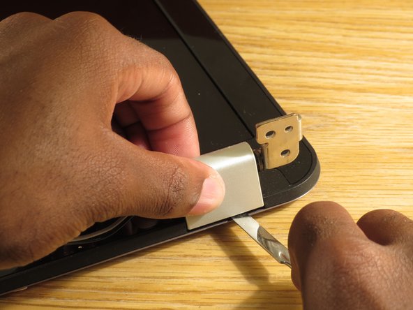

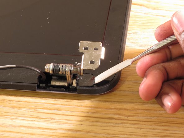

  14. HP DV7-4285DX LCD Replacement: crwdns2935265:014crwdnd2935265:01crwdnd2935265:03crwdne2935265:0 HP DV7-4285DX LCD Replacement: crwdns2935265:014crwdnd2935265:02crwdnd2935265:03crwdne2935265:0 HP DV7-4285DX LCD Replacement: crwdns2935265:014crwdnd2935265:03crwdnd2935265:03crwdne2935265:0
    • Using a metal spudger remove the two hinge covers.
    • Use a metal spudger to remove the two screw covers.

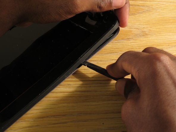

  15. HP DV7-4285DX LCD Replacement: crwdns2935265:015crwdnd2935265:01crwdnd2935265:03crwdne2935265:0 HP DV7-4285DX LCD Replacement: crwdns2935265:015crwdnd2935265:02crwdnd2935265:03crwdne2935265:0 HP DV7-4285DX LCD Replacement: crwdns2935265:015crwdnd2935265:03crwdnd2935265:03crwdne2935265:0
    • Remove the two Phillips #1 screws that were under the covers.
    • Starting on the left side, use a spudger to pry the bezel up.
    • Work your way around and remove the bezel.

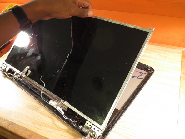

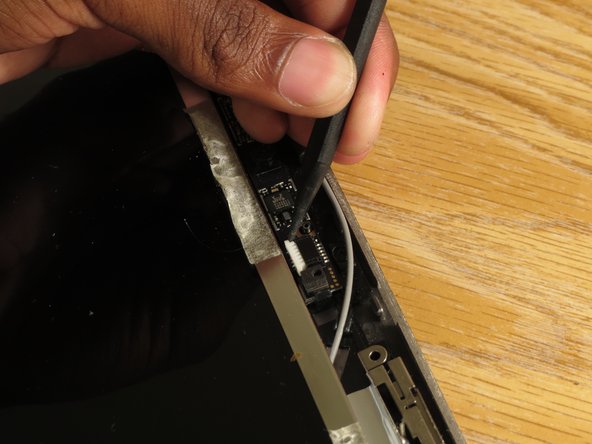

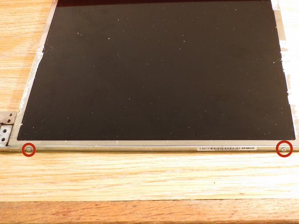

  16. HP DV7-4285DX LCD Replacement: crwdns2935265:016crwdnd2935265:01crwdnd2935265:03crwdne2935265:0 HP DV7-4285DX LCD Replacement: crwdns2935265:016crwdnd2935265:02crwdnd2935265:03crwdne2935265:0 HP DV7-4285DX LCD Replacement: crwdns2935265:016crwdnd2935265:03crwdnd2935265:03crwdne2935265:0
    • Remove the eight screws holding the LCD panel.
    • Eight Phillips #1
    • Use a spudger to disconnect the webcam connector.
    • Lift up the LCD panel.
    • The webcam wire is attached to the back of the panel. Carefully peel it off the panel.

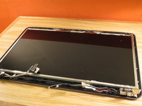

  17. HP DV7-4285DX LCD Replacement: crwdns2935265:017crwdnd2935265:01crwdnd2935265:01crwdne2935265:0
    • Use a sudger to disconnect the wire from the LCD panel.
    • Remove LCD panel.

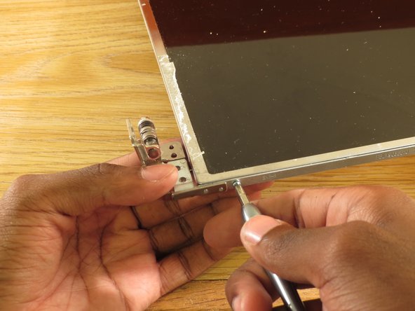

  18. HP DV7-4285DX LCD Replacement: crwdns2935265:018crwdnd2935265:01crwdnd2935265:03crwdne2935265:0 HP DV7-4285DX LCD Replacement: crwdns2935265:018crwdnd2935265:02crwdnd2935265:03crwdne2935265:0 HP DV7-4285DX LCD Replacement: crwdns2935265:018crwdnd2935265:03crwdnd2935265:03crwdne2935265:0
    • Remove the four screws (two on each side) holding the hinges on the sides.
    • Four Phillips #1 (two on each side)
    • Remove the hinges.
