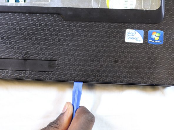

    • Open up the front of the laptop. Use a plastic opening tool to carefully pry open the keyboard from the edges.

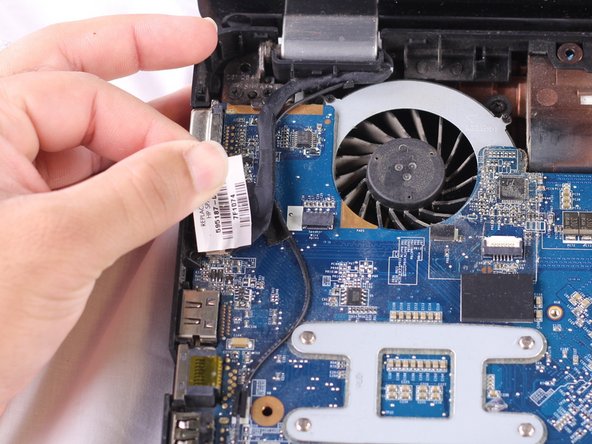

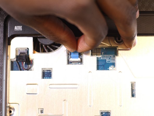

    • Locate the keyboard cable/wire that attaches the keyboard to the laptop .
    • Locate the latch of the wire connector
    • Unlatch the wire connector and gently pull out the wire with your hands

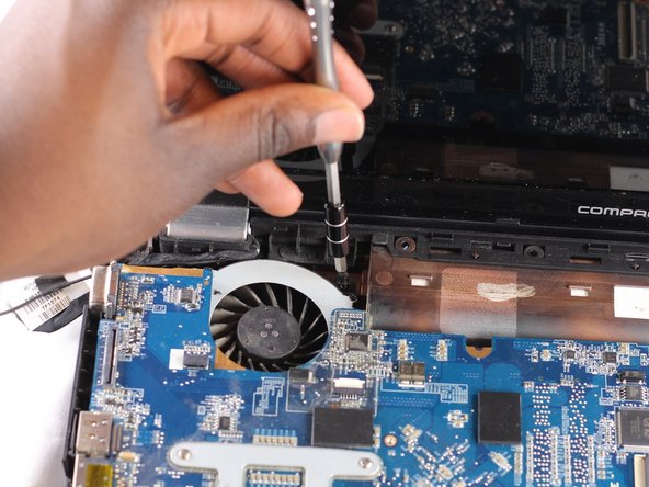

    • Remove the four M2.5x5 mm Phillips screws from the exposed keyboard cover.

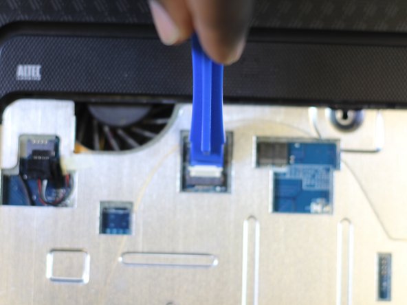

    • Locate the three tab holding down the cover of the Motherboard.
    • Lift the tabs with using either a plastic opening tool or your fingers.

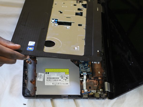

    • Using a plastic opening tool to lift the sides of the cover.
  9. HP Compaq Presario cq62-214nr Motherboard Replacement: crwdns2935265:09crwdnd2935265:01crwdnd2935265:03crwdne2935265:0 HP Compaq Presario cq62-214nr Motherboard Replacement: crwdns2935265:09crwdnd2935265:02crwdnd2935265:03crwdne2935265:0 HP Compaq Presario cq62-214nr Motherboard Replacement: crwdns2935265:09crwdnd2935265:03crwdnd2935265:03crwdne2935265:0
    • Use your hands to gently lift the cover off.

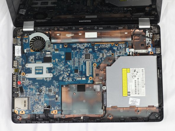

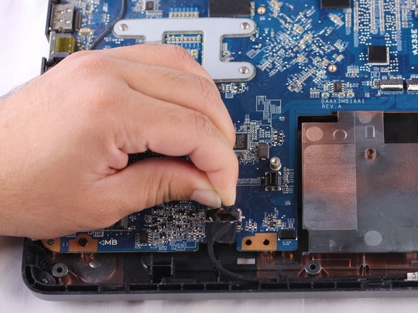

    • Locate the four cables securing the Motherboard.
    • Gently pull cables to unsecure them.
  11. HP Compaq Presario cq62-214nr Motherboard Replacement: crwdns2935265:011crwdnd2935265:01crwdnd2935265:03crwdne2935265:0 HP Compaq Presario cq62-214nr Motherboard Replacement: crwdns2935265:011crwdnd2935265:02crwdnd2935265:03crwdne2935265:0 HP Compaq Presario cq62-214nr Motherboard Replacement: crwdns2935265:011crwdnd2935265:03crwdnd2935265:03crwdne2935265:0

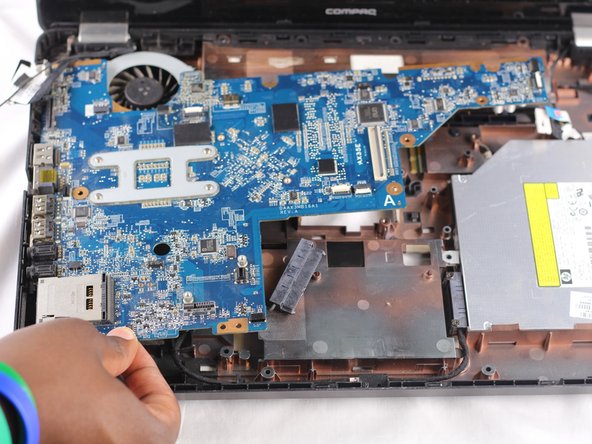

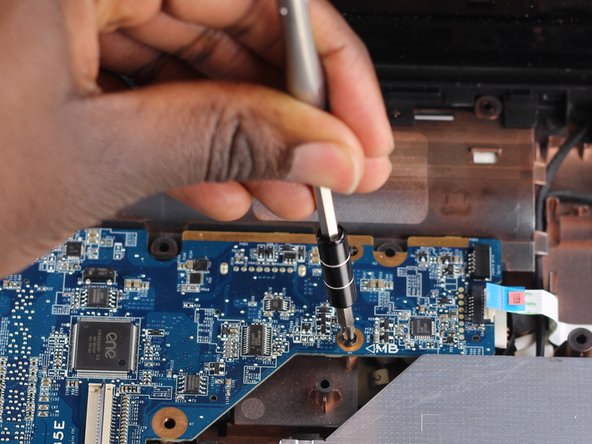

    • Remove the three M2.25x5 mm Phillips screws.

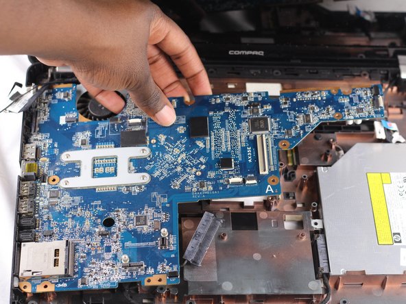

  12. HP Compaq Presario cq62-214nr Motherboard Replacement: crwdns2935265:012crwdnd2935265:01crwdnd2935265:03crwdne2935265:0 HP Compaq Presario cq62-214nr Motherboard Replacement: crwdns2935265:012crwdnd2935265:02crwdnd2935265:03crwdne2935265:0 HP Compaq Presario cq62-214nr Motherboard Replacement: crwdns2935265:012crwdnd2935265:03crwdnd2935265:03crwdne2935265:0
    • Unlatch the final cable and gently remove the Motherboard.
