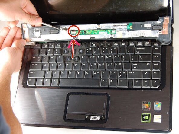

    • Use the metal spudger to gently remove the plastic plate from the rest of the top panel.
    • Be careful not to break the plastic tabs connecting the two top panels.

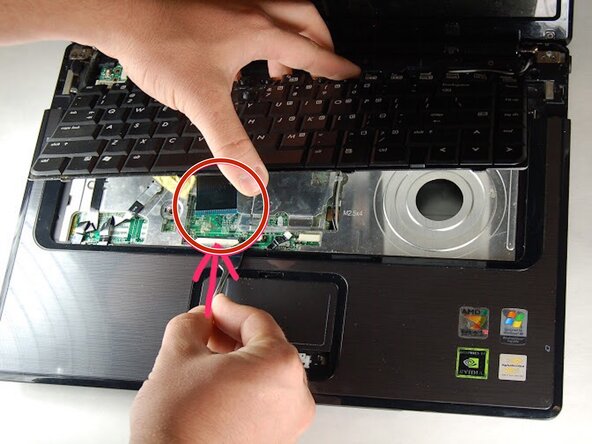

  2. HP Compaq Presario V6000 Trackpad Replacement: crwdns2935265:02crwdnd2935265:01crwdnd2935265:01crwdne2935265:0
    • Separate the connection of the top piece from the board.
  3. HP Compaq Presario V6000 Trackpad Replacement: crwdns2935265:03crwdnd2935265:01crwdnd2935265:01crwdne2935265:0
    • Remove the connection from the keyboard to its housing.

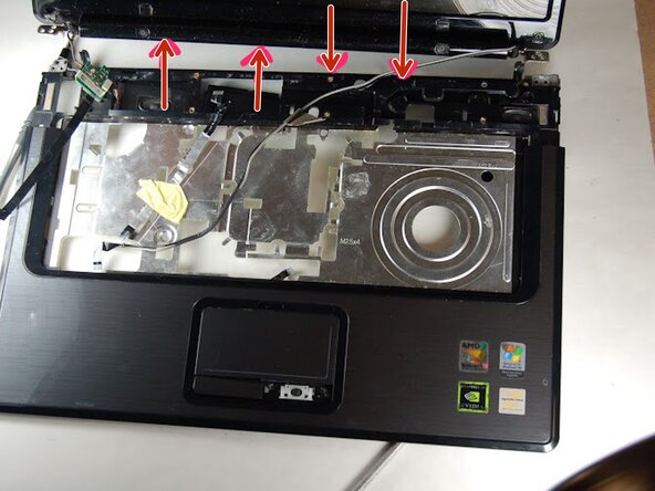

  4. HP Compaq Presario V6000 Trackpad Replacement: crwdns2935265:04crwdnd2935265:01crwdnd2935265:01crwdne2935265:0
    • Separate the power connections.

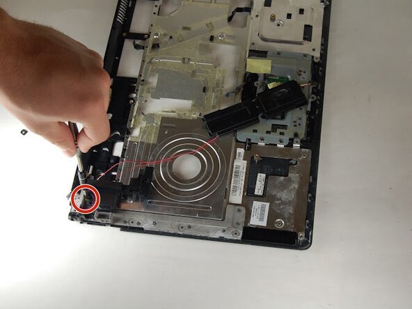

  5. HP Compaq Presario V6000 Trackpad Replacement: crwdns2935265:05crwdnd2935265:01crwdnd2935265:01crwdne2935265:0
    • Unravel the wire.

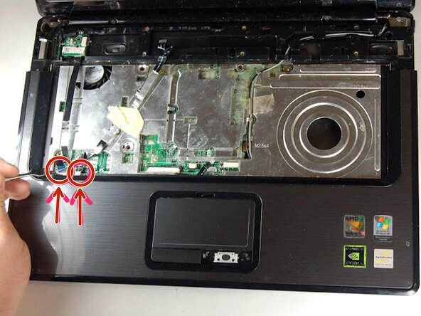

  6. HP Compaq Presario V6000 Trackpad Replacement: crwdns2935265:06crwdnd2935265:01crwdnd2935265:01crwdne2935265:0
    • Remove the screws connecting the plastic housing to the screen.
    • Use caution when removing the last screen. Do no damage the screen.

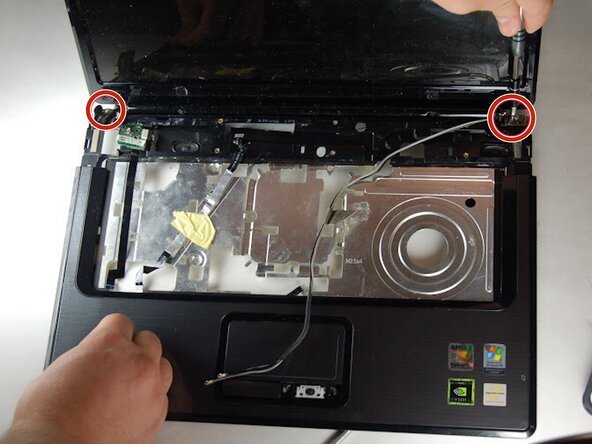

  7. HP Compaq Presario V6000 Trackpad Replacement: crwdns2935265:07crwdnd2935265:01crwdnd2935265:01crwdne2935265:0
    • Make sure to grip the screen tightly and separate the top and bottom.
  8. HP Compaq Presario V6000 Trackpad Replacement: crwdns2935265:08crwdnd2935265:01crwdnd2935265:02crwdne2935265:0 HP Compaq Presario V6000 Trackpad Replacement: crwdns2935265:08crwdnd2935265:02crwdnd2935265:02crwdne2935265:0
    • Remove the screws that hold the track pad in place.
    • Remove the track pad.
