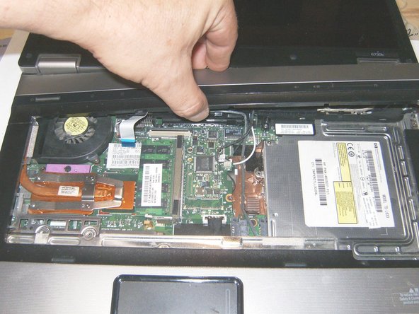

  4. HP Compaq 6730b Fan Replacement: crwdns2935265:04crwdnd2935265:01crwdnd2935265:03crwdne2935265:0 HP Compaq 6730b Fan Replacement: crwdns2935265:04crwdnd2935265:02crwdnd2935265:03crwdne2935265:0 HP Compaq 6730b Fan Replacement: crwdns2935265:04crwdnd2935265:03crwdnd2935265:03crwdne2935265:0
    • Release the Zif connector to which the power button board cable is connected, by lifting the clasp of the Zif connector in an upward direction.
    • Lift the left and right sides of the switch cover until it detaches from the computer, but do not yet try to remove it.
    • The LED board cable is still attached, disconnect it from the Zif connector by simply pulling it out in an upward direction.
  5. HP Compaq 6730b Fan Replacement: crwdns2935265:05crwdnd2935265:01crwdnd2935265:03crwdne2935265:0 HP Compaq 6730b Fan Replacement: crwdns2935265:05crwdnd2935265:02crwdnd2935265:03crwdne2935265:0 HP Compaq 6730b Fan Replacement: crwdns2935265:05crwdnd2935265:03crwdnd2935265:03crwdne2935265:0
    • Remove the fan connector. (it is not necessary to use forceps or any other tool)
    • Loosen the two Phillips 2.5×7.0 screws that secure the fan to the base enclosure.
    • Remove the fan from the case.

Thanks a million for this. My lap top is… old. Fan has been swirling away like crazy for years. Just followed your advice and it sounds like new.
Kind regards,
Gill
