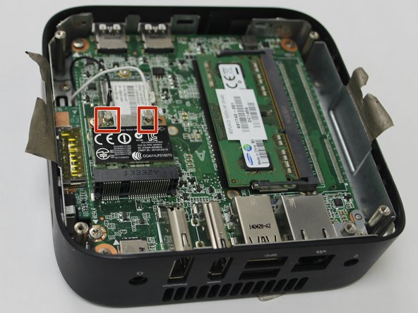

  8. HP Chromebox J5N50UT System Board Replacement, WLAN Module: crwdns2935265:08crwdnd2935265:01crwdnd2935265:02crwdne2935265:0 HP Chromebox J5N50UT System Board Replacement, WLAN Module: crwdns2935265:08crwdnd2935265:02crwdnd2935265:02crwdne2935265:0
    • Disconnect the white and black antenna cables from the module.
  9. HP Chromebox J5N50UT System Board Replacement: crwdns2935265:09crwdnd2935265:01crwdnd2935265:03crwdne2935265:0 HP Chromebox J5N50UT System Board Replacement: crwdns2935265:09crwdnd2935265:02crwdnd2935265:03crwdne2935265:0 HP Chromebox J5N50UT System Board Replacement: crwdns2935265:09crwdnd2935265:03crwdnd2935265:03crwdne2935265:0
    • Using your Phillips #1 screwdriver, remove the M2.0×3.0 screw from the upper left corner of the module.
    • Once the screw has been removed, the module will tilt up.

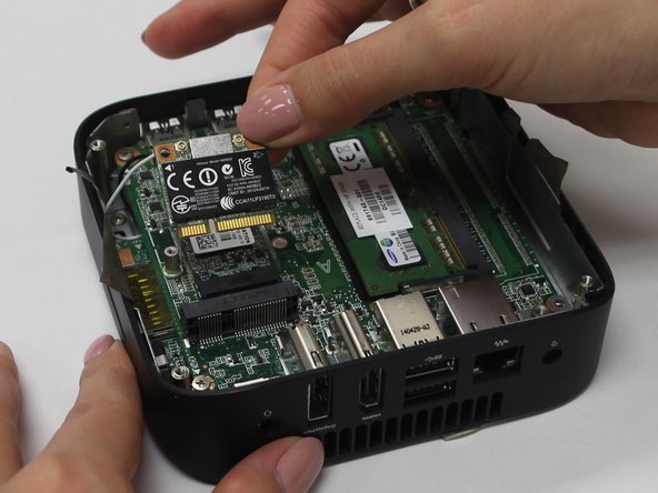

  10. HP Chromebox J5N50UT System Board Replacement: crwdns2935265:010crwdnd2935265:01crwdnd2935265:02crwdne2935265:0 HP Chromebox J5N50UT System Board Replacement: crwdns2935265:010crwdnd2935265:02crwdnd2935265:02crwdne2935265:0
    • Remove the WLAN module by pulling it away from the slot at an angle.

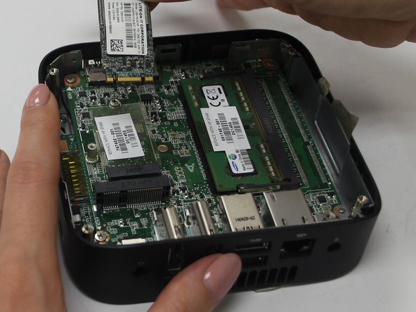

  11. HP Chromebox J5N50UT System Board Replacement, Hard Drive: crwdns2935265:011crwdnd2935265:01crwdnd2935265:02crwdne2935265:0 HP Chromebox J5N50UT System Board Replacement, Hard Drive: crwdns2935265:011crwdnd2935265:02crwdnd2935265:02crwdne2935265:0
    • Remove the Phillips M2.0×3.0 screw.
    • The hard drive will tilt up once the screw has been removed.
  12. HP Chromebox J5N50UT System Board Replacement: crwdns2935265:012crwdnd2935265:01crwdnd2935265:02crwdne2935265:0 HP Chromebox J5N50UT System Board Replacement: crwdns2935265:012crwdnd2935265:02crwdnd2935265:02crwdne2935265:0
    • Pull the hard drive at an angle to remove it from its slot.
