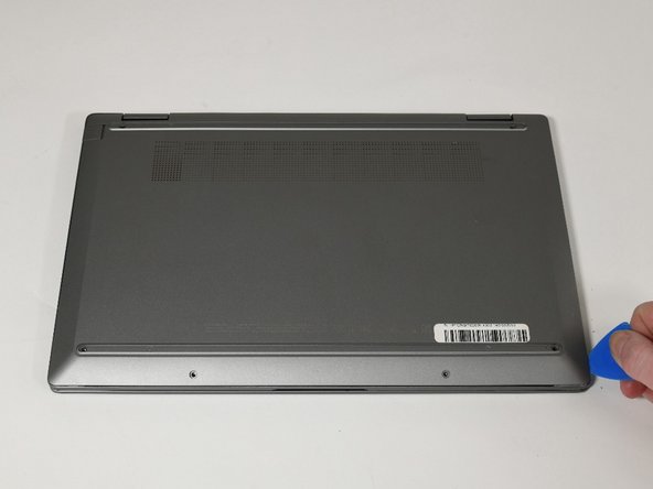

    • Use tweezers to apply light pressure on the outer sides of the 2 small screw covers located near the bottom of the device.
    • Rotate the covers until they pop up out of the screw socket enough to remove them with tweezers.

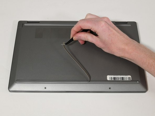

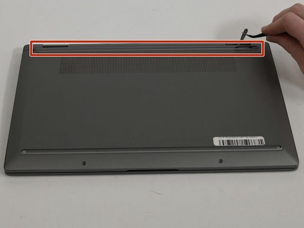

    • Use tweezers to peel back the feet on the top and bottom of the Chromebook to reveal four additional screws.

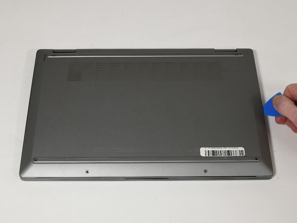

    • Insert an opening pick between lower case and chassis.
    • Separate the lower case from the frame by sliding the opening pick along the perimeter until the case releases.
