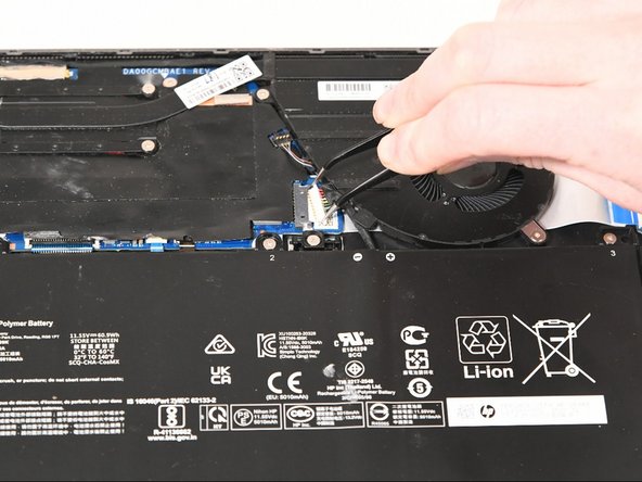

  7. HP Chromebook x360 14c-ca0053 Battery Replacement, Battery: crwdns2935265:07crwdnd2935265:01crwdnd2935265:03crwdne2935265:0 HP Chromebook x360 14c-ca0053 Battery Replacement, Battery: crwdns2935265:07crwdnd2935265:02crwdnd2935265:03crwdne2935265:0 HP Chromebook x360 14c-ca0053 Battery Replacement, Battery: crwdns2935265:07crwdnd2935265:03crwdnd2935265:03crwdne2935265:0
    • Open the tweezers wide enough to fit on each side of motherboard battery connection.
    • Pull the connector directly out of its socket.

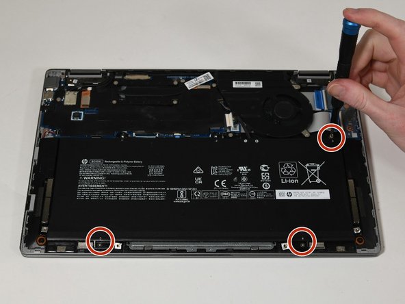

  8. HP Chromebook x360 14c-ca0053 Battery Replacement: crwdns2935265:08crwdnd2935265:01crwdnd2935265:02crwdne2935265:0 HP Chromebook x360 14c-ca0053 Battery Replacement: crwdns2935265:08crwdnd2935265:02crwdnd2935265:02crwdne2935265:0
    • Use a Phillips #0 screwdriver to remove the five 3 mm screws that secure the battery.
    • These screws are labeled 1-5.

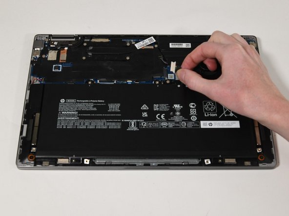

  9. HP Chromebook x360 14c-ca0053 Battery Replacement: crwdns2935265:09crwdnd2935265:01crwdnd2935265:01crwdne2935265:0
    • Lift the battery up and out.
    • Be careful as to not puncture or damage the battery.
