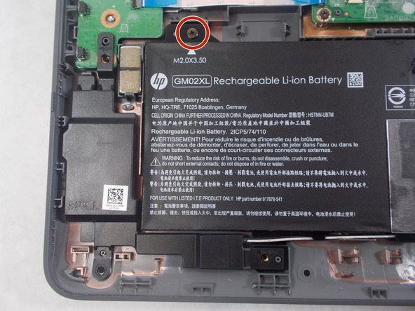

  8. HP Chromebook x360 11-ae010nr Battery Replacement, Battery: crwdns2935265:08crwdnd2935265:01crwdnd2935265:02crwdne2935265:0 HP Chromebook x360 11-ae010nr Battery Replacement, Battery: crwdns2935265:08crwdnd2935265:02crwdnd2935265:02crwdne2935265:0
    • Remove the two 5 mm Phillips #1 screws from each side of the battery.

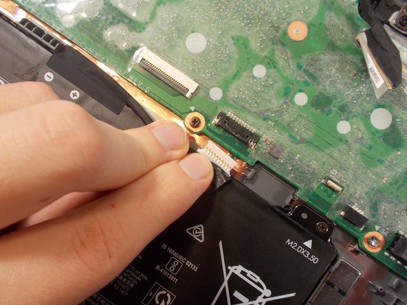

  9. HP Chromebook x360 11-ae010nr Battery Replacement: crwdns2935265:09crwdnd2935265:01crwdnd2935265:02crwdne2935265:0 HP Chromebook x360 11-ae010nr Battery Replacement: crwdns2935265:09crwdnd2935265:02crwdnd2935265:02crwdne2935265:0
    • Remove the tape from the cable using a pair of tweezers.
    • Gently remove the cable from the plug.
    • Remove the battery from the laptop.
