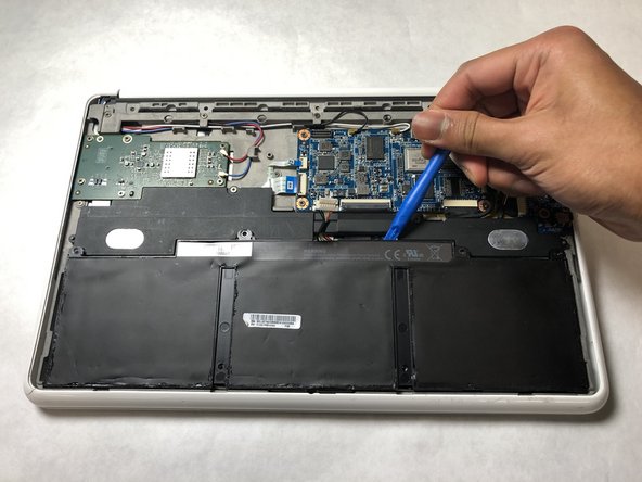

    • Flip the Chromebook over, and starting at the top right or left hand corner of the large blue piece, use the plastic opening tool to remove it.
    • Remove six 4.77mm screws using the Phillips #1 screwdriver.
    • This part has fragile plastic connectors on it. Do not damage them.
  2. HP Chromebook CB2L Trackpad Replacement: crwdns2935265:02crwdnd2935265:01crwdnd2935265:03crwdne2935265:0 HP Chromebook CB2L Trackpad Replacement: crwdns2935265:02crwdnd2935265:02crwdnd2935265:03crwdne2935265:0 HP Chromebook CB2L Trackpad Replacement: crwdns2935265:02crwdnd2935265:03crwdnd2935265:03crwdne2935265:0
    • Starting at either the top left or right hand corner of the exposed metal piece, use the blue plastic opening tool to remove the back panel.
  3. HP Chromebook CB2L Trackpad Replacement: crwdns2935265:03crwdnd2935265:01crwdnd2935265:02crwdne2935265:0 HP Chromebook CB2L Trackpad Replacement: crwdns2935265:03crwdnd2935265:02crwdnd2935265:02crwdne2935265:0
    • Remove four 3.42mm screws using the Phillips #1 screwdriver.
    • Disconnect the battery from the motherboard.
    • Remove the battery.
  4. HP Chromebook CB2L Trackpad Replacement: crwdns2935265:04crwdnd2935265:01crwdnd2935265:01crwdne2935265:0
    • Remove four 2.57mm screws using the Phillips #1 screwdriver.
    • Remove single 2.43mm screw using the Phillips #1 screwdriver.
  5. HP Chromebook CB2L Trackpad Replacement: crwdns2935265:05crwdnd2935265:01crwdnd2935265:03crwdne2935265:0 HP Chromebook CB2L Trackpad Replacement: crwdns2935265:05crwdnd2935265:02crwdnd2935265:03crwdne2935265:0 HP Chromebook CB2L Trackpad Replacement: crwdns2935265:05crwdnd2935265:03crwdnd2935265:03crwdne2935265:0
    • Remove the metal piece along the bottom of the trackpad.
    • Use the plastic opening tool to carefully flip the black piece on the ribbon cable holder then remove the ribbon cable.
    • Push the trackpad out from the keyboard side.
