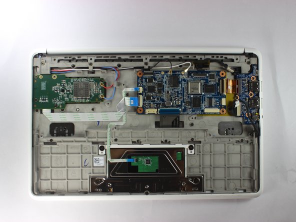

  11. HP Chromebook CB2L Motherboard Replacement: crwdns2935265:011crwdnd2935265:01crwdnd2935265:02crwdne2935265:0 HP Chromebook CB2L Motherboard Replacement: crwdns2935265:011crwdnd2935265:02crwdnd2935265:02crwdne2935265:0
    • Lift the black tab using the plastic opening tool.
    • Remove the two white strips from the motherboard.

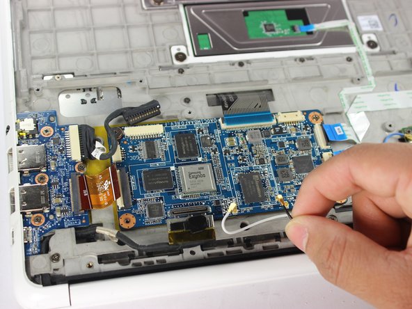

  12. HP Chromebook CB2L Motherboard Replacement: crwdns2935265:012crwdnd2935265:01crwdnd2935265:02crwdne2935265:0 HP Chromebook CB2L Motherboard Replacement: crwdns2935265:012crwdnd2935265:02crwdnd2935265:02crwdne2935265:0
    • Lift the black and silver connector using plastic opening tool as shown.
    • Remove the white and black wires by rotating them counterclockwise and gently lifting them.

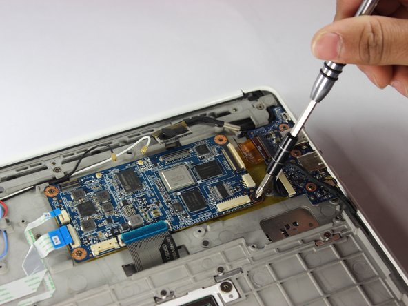

  13. HP Chromebook CB2L Motherboard Replacement: crwdns2935265:013crwdnd2935265:01crwdnd2935265:03crwdne2935265:0 HP Chromebook CB2L Motherboard Replacement: crwdns2935265:013crwdnd2935265:02crwdnd2935265:03crwdne2935265:0 HP Chromebook CB2L Motherboard Replacement: crwdns2935265:013crwdnd2935265:03crwdnd2935265:03crwdne2935265:0
    • Remove the three 1.2mm screws using the Phillips #1 screwdriver.
  14. HP Chromebook CB2L Motherboard Replacement: crwdns2935265:014crwdnd2935265:01crwdnd2935265:01crwdne2935265:0
    • Using the plastic opening tool lift the motherboard out of the back panel.
