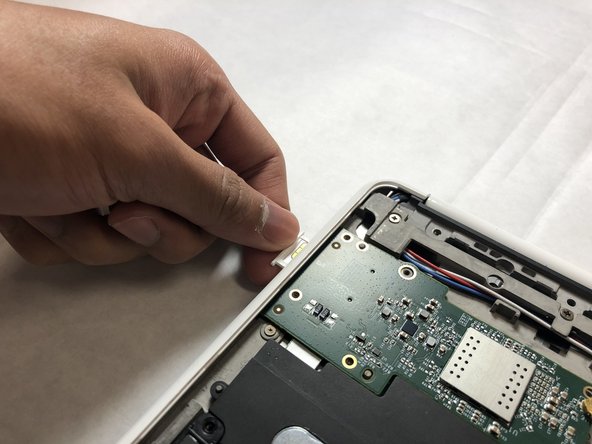

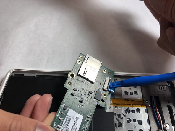

  6. HP Chromebook CB2L Keyboard Replacement: crwdns2935265:06crwdnd2935265:01crwdnd2935265:03crwdne2935265:0 HP Chromebook CB2L Keyboard Replacement: crwdns2935265:06crwdnd2935265:02crwdnd2935265:03crwdne2935265:0 HP Chromebook CB2L Keyboard Replacement: crwdns2935265:06crwdnd2935265:03crwdnd2935265:03crwdne2935265:0
    • Remove the red and blue antennae wires from the SIM card board.
    • Remove the SIM card tray.
    • Flip the board over and use the plastic opening tool to remove the ribbon cable, then remove the board.
