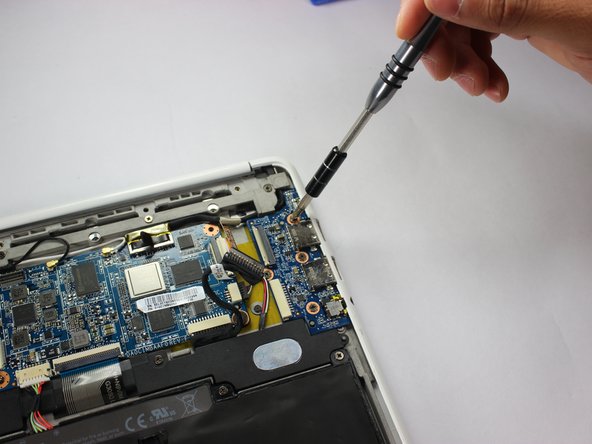

  4. HP Chromebook CB2L Audio Port Replacement: crwdns2935265:04crwdnd2935265:01crwdnd2935265:02crwdne2935265:0 HP Chromebook CB2L Audio Port Replacement: crwdns2935265:04crwdnd2935265:02crwdnd2935265:02crwdne2935265:0
    • Unscrew four 1.2mm Phillips screws using Phillips #1 screwdriver.
  5. HP Chromebook CB2L Audio Port Replacement: crwdns2935265:05crwdnd2935265:01crwdnd2935265:01crwdne2935265:0
    • Using the plastic opening tool remove the audio port from the back panel.
