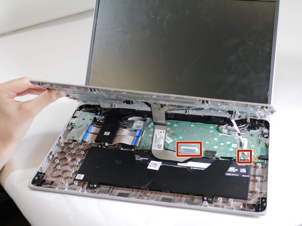

    • Flip the device over so it is right side up and open it.
    • Use a Jimmy to gently pry between the keyboard and case.
    • Lift the top panel gently. Once loose, ribbon cables inside will need to be detached.
    • Pry gently to pop open the plastic tabs holding the top panel in. A clicking noise will occur during this step
    • Continue prying, moving around all sides of the panel until it is loose.
    • Carefully lift the top panel from the device body.
  3. HP Chromebook 14a-ne0013dx Screen Replacement: crwdns2935265:03crwdnd2935265:01crwdnd2935265:02crwdne2935265:0 HP Chromebook 14a-ne0013dx Screen Replacement: crwdns2935265:03crwdnd2935265:02crwdnd2935265:02crwdne2935265:0
    • Removal of ribbon cables may require lifting or peeling tape.
    • Lift the top piece of the display cable's housing until it is loose. Gently pull it free.
    • Lift the top piece of the touchpad cable's housing until it is loose. Gently pull it free.
    • With the cables detached, lift the front panel away from the device.

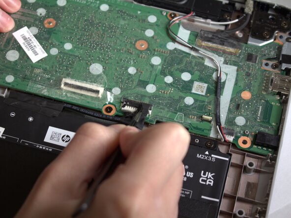

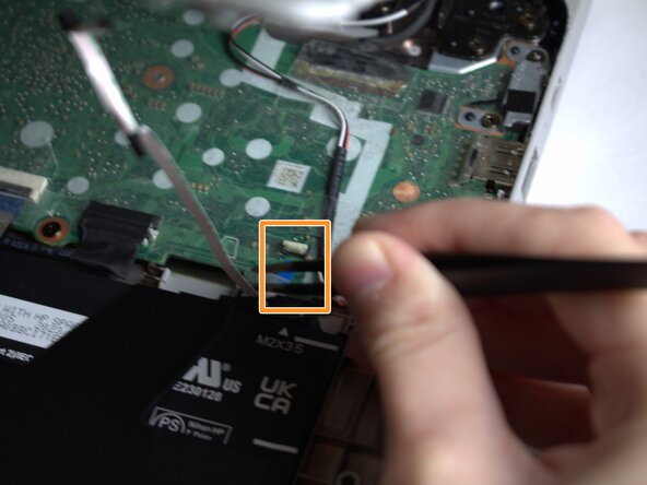

  4. HP Chromebook 14a-ne0013dx Screen Replacement, Battery: crwdns2935265:04crwdnd2935265:01crwdnd2935265:02crwdne2935265:0 HP Chromebook 14a-ne0013dx Screen Replacement, Battery: crwdns2935265:04crwdnd2935265:02crwdnd2935265:02crwdne2935265:0
    • Peel the tape off of the cable connecting the battery to the motherboard.
    • Grasp the connector and tug until loose.

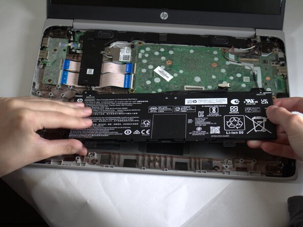

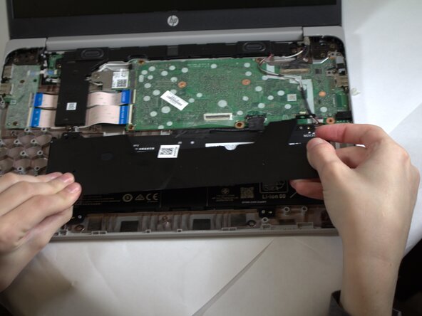

  5. HP Chromebook 14a-ne0013dx Screen Replacement: crwdns2935265:05crwdnd2935265:01crwdnd2935265:03crwdne2935265:0 HP Chromebook 14a-ne0013dx Screen Replacement: crwdns2935265:05crwdnd2935265:02crwdnd2935265:03crwdne2935265:0 HP Chromebook 14a-ne0013dx Screen Replacement: crwdns2935265:05crwdnd2935265:03crwdnd2935265:03crwdne2935265:0
    • Remove the four 3 mm screws from the battery casing using a Phillips #0 screwdriver.
    • Gently peel the tape pieces connecting the battery to cables on the bottom panel.
    • Lift the top panel off, then lift the battery out of the casing.

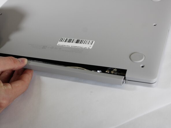

  6. HP Chromebook 14a-ne0013dx Screen Replacement, Hinge: crwdns2935265:06crwdnd2935265:01crwdnd2935265:03crwdne2935265:0 HP Chromebook 14a-ne0013dx Screen Replacement, Hinge: crwdns2935265:06crwdnd2935265:02crwdnd2935265:03crwdne2935265:0 HP Chromebook 14a-ne0013dx Screen Replacement, Hinge: crwdns2935265:06crwdnd2935265:03crwdnd2935265:03crwdne2935265:0
    • Turn the device so that the plastic hinge piece on the back is facing towards you.
    • Pry the edge of the plastic hinge piece until it comes out freely.

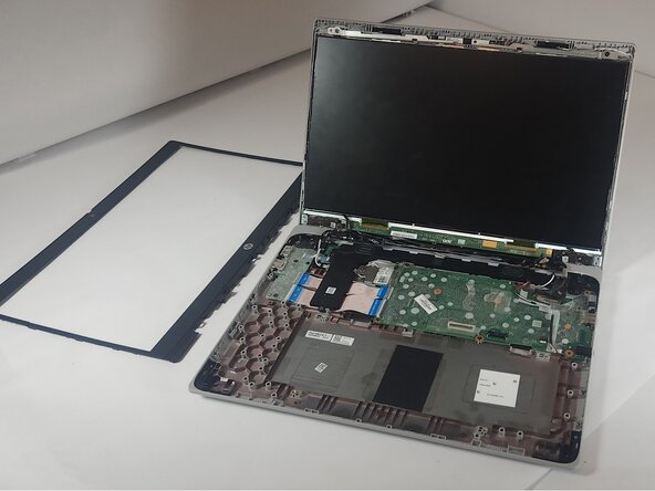

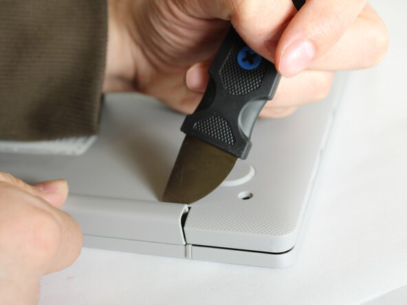

  7. HP Chromebook 14a-ne0013dx Screen Replacement: crwdns2935265:07crwdnd2935265:01crwdnd2935265:02crwdne2935265:0 HP Chromebook 14a-ne0013dx Screen Replacement: crwdns2935265:07crwdnd2935265:02crwdnd2935265:02crwdne2935265:0
    • Use care when prying to avoid breaking the trim or damaging the screen. The trim on the bottom of the screen has additional glue attaching it, so more force may be needed.
    • Using the metal “Jimmy,” pry the plastic trim on the front of the screen so that it is loose.
    • Lift the trim piece away from the screen.

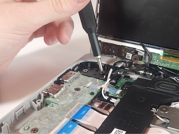

  8. HP Chromebook 14a-ne0013dx Screen Replacement: crwdns2935265:08crwdnd2935265:01crwdnd2935265:02crwdne2935265:0 HP Chromebook 14a-ne0013dx Screen Replacement: crwdns2935265:08crwdnd2935265:02crwdnd2935265:02crwdne2935265:0

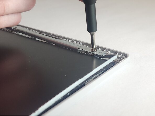

    • Remove four 2 mm screws securing the metal hinge base to the bottom panel (two screws per hinge).

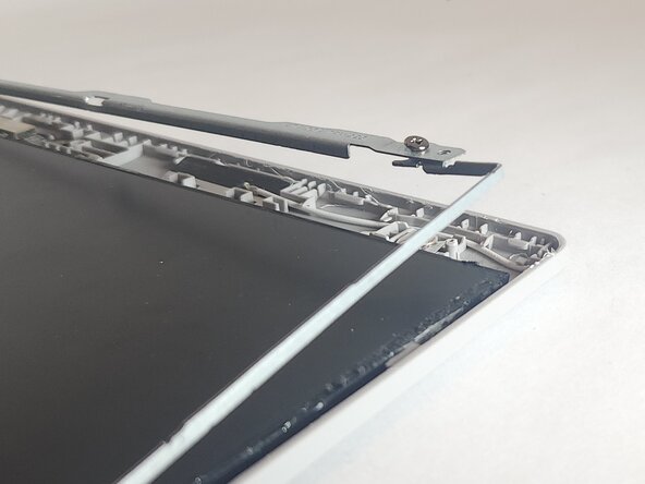

  9. HP Chromebook 14a-ne0013dx Screen Replacement: crwdns2935265:09crwdnd2935265:01crwdnd2935265:03crwdne2935265:0 HP Chromebook 14a-ne0013dx Screen Replacement: crwdns2935265:09crwdnd2935265:02crwdnd2935265:03crwdne2935265:0 HP Chromebook 14a-ne0013dx Screen Replacement: crwdns2935265:09crwdnd2935265:03crwdnd2935265:03crwdne2935265:0
    • Remove the two 1 mm screws holding in the metal frame with a Phillips #00 screwdriver.
    • Remove the six 1 mm screws found at the bottom of the screen with a Phillips #00 screwdriver.
    • Remove the two 8 mm screws with a Phillips #00 screwdriver.
    • These might be difficult to reach, due to being close to wires.

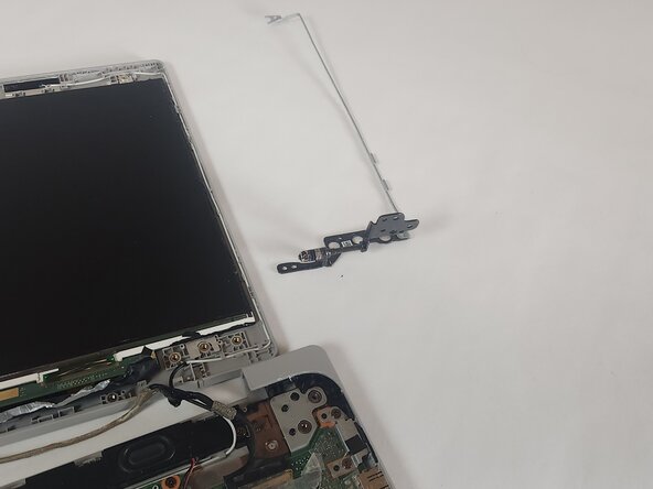

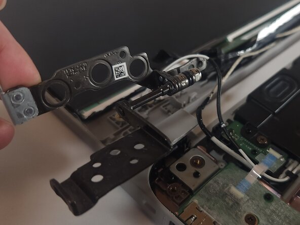

  10. HP Chromebook 14a-ne0013dx Screen Replacement: crwdns2935265:010crwdnd2935265:01crwdnd2935265:03crwdne2935265:0 HP Chromebook 14a-ne0013dx Screen Replacement: crwdns2935265:010crwdnd2935265:02crwdnd2935265:03crwdne2935265:0 HP Chromebook 14a-ne0013dx Screen Replacement: crwdns2935265:010crwdnd2935265:03crwdnd2935265:03crwdne2935265:0
    • When removing the hinge, wires will be blocking the way, so take care when removing the hinge.
    • Remove the hinge, by sliding it out, gently.

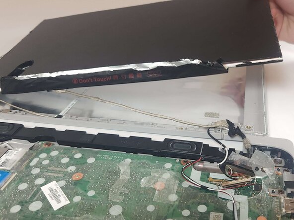

  11. HP Chromebook 14a-ne0013dx Screen Replacement, Screen: crwdns2935265:011crwdnd2935265:01crwdnd2935265:02crwdne2935265:0 HP Chromebook 14a-ne0013dx Screen Replacement, Screen: crwdns2935265:011crwdnd2935265:02crwdnd2935265:02crwdne2935265:0
    • One at a time, pull the two pieces of black tape from under the bottom corners of the screen until they are fully removed.
    • The screen will come loose from the back panel.

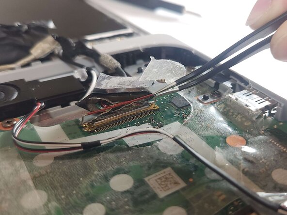

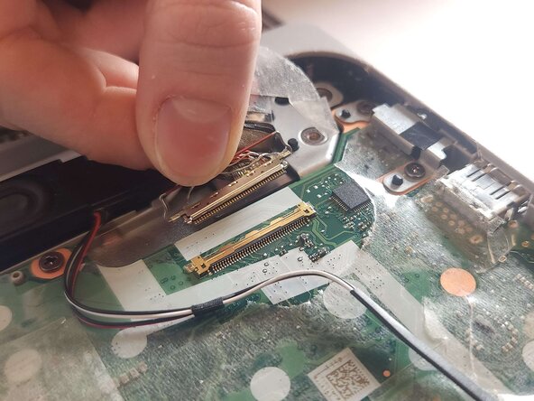

  12. HP Chromebook 14a-ne0013dx Screen Replacement: crwdns2935265:012crwdnd2935265:01crwdnd2935265:03crwdne2935265:0 HP Chromebook 14a-ne0013dx Screen Replacement: crwdns2935265:012crwdnd2935265:02crwdnd2935265:03crwdne2935265:0 HP Chromebook 14a-ne0013dx Screen Replacement: crwdns2935265:012crwdnd2935265:03crwdnd2935265:03crwdne2935265:0
    • Peel away the tape covering the display cable connector, then grasp and pull until it disconnects.
    • Remove the screen from the laptop.
