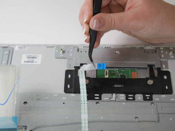

    • To safely remove the ribbon cable securing the touchpad ribbon cable is a ZIF connector, use the angled tweezers to lift up the plastic flap of the ZIF connector.
    • Use the angled tweezers to pull the touchpad ribbon cable from the connector on the motherboard.

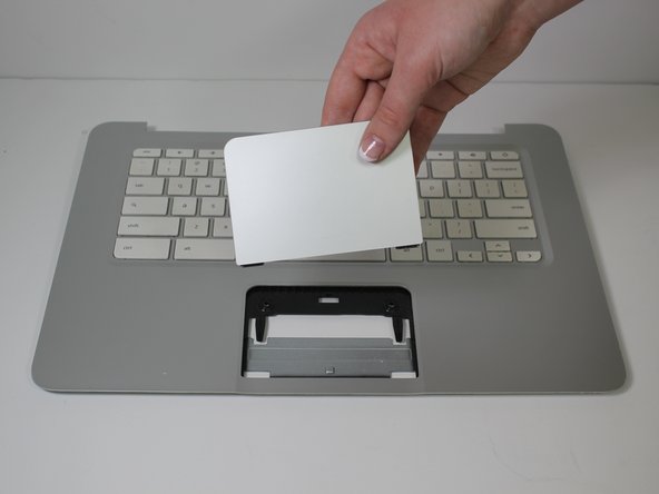

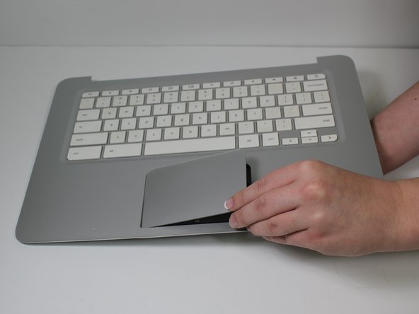

    • Turn the keyboard so that it faces upwards.
    • Use your fingers to gently remove the touchpad from the keyboard.
