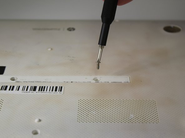

    • Flip the laptop upside down so that the bottom is facing upwards.
    • Use Phillips #0 screwdriver to remove nine 6.7 mm screws from the bottom panel.

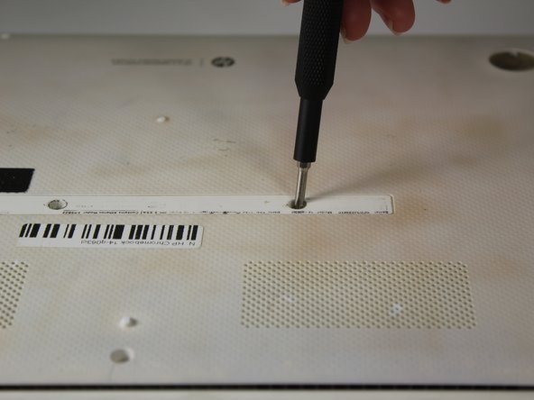

  2. HP Chromebook 14-q063cl Motherboard Replacement: crwdns2935265:02crwdnd2935265:01crwdnd2935265:03crwdne2935265:0 HP Chromebook 14-q063cl Motherboard Replacement: crwdns2935265:02crwdnd2935265:02crwdnd2935265:03crwdne2935265:0 HP Chromebook 14-q063cl Motherboard Replacement: crwdns2935265:02crwdnd2935265:03crwdnd2935265:03crwdne2935265:0
    • Use a metal spudger to pry the plastic covers off four additional screws.
  3. HP Chromebook 14-q063cl Motherboard Replacement: crwdns2935265:03crwdnd2935265:01crwdnd2935265:03crwdne2935265:0 HP Chromebook 14-q063cl Motherboard Replacement: crwdns2935265:03crwdnd2935265:02crwdnd2935265:03crwdne2935265:0 HP Chromebook 14-q063cl Motherboard Replacement: crwdns2935265:03crwdnd2935265:03crwdnd2935265:03crwdne2935265:0
    • Use a Phillips #0 screwdriver to remove the four remaining 6.7 mm screws from the bottom panel.

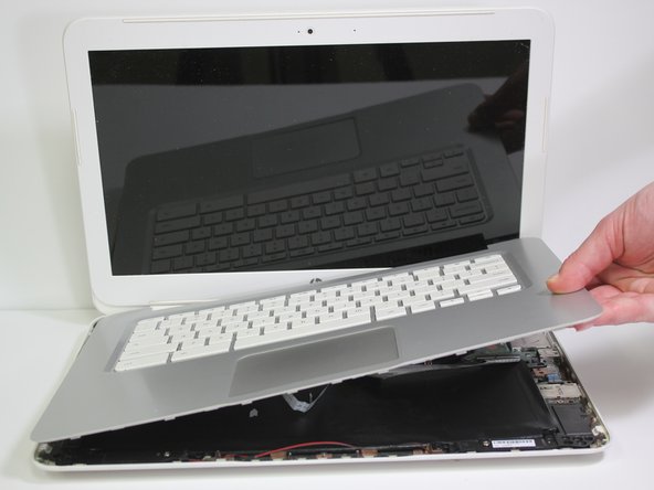

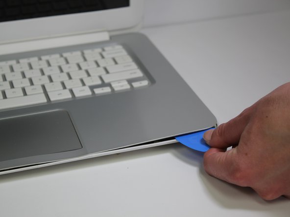

    • Turn the laptop upright. Open it so the screen is visible.
    • Use an opening tool or picks to undo the clips around the perimeter of the keyboard assembly and separate it from the rest of the laptop
    • Disconnect the ribbon cables attaching the keyboard to the motherboard.
    • Use caution when performing this step so as to not break the keyboard assembly or rip any cables or connectors connected to the board. Don't yank the keyboard assembly from the device.

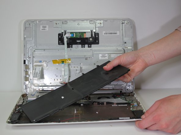

  5. HP Chromebook 14-q063cl Motherboard Replacement: crwdns2935265:05crwdnd2935265:01crwdnd2935265:03crwdne2935265:0 HP Chromebook 14-q063cl Motherboard Replacement: crwdns2935265:05crwdnd2935265:02crwdnd2935265:03crwdne2935265:0 HP Chromebook 14-q063cl Motherboard Replacement: crwdns2935265:05crwdnd2935265:03crwdnd2935265:03crwdne2935265:0

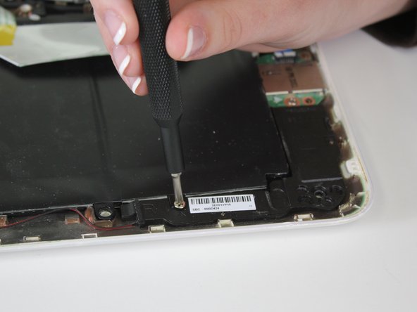

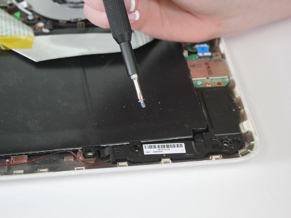

    • Use a Phillips #0 screwdriver to remove three 4.6 mm screws securing the battery to the case.
  6. HP Chromebook 14-q063cl Motherboard Replacement: crwdns2935265:06crwdnd2935265:01crwdnd2935265:03crwdne2935265:0 HP Chromebook 14-q063cl Motherboard Replacement: crwdns2935265:06crwdnd2935265:02crwdnd2935265:03crwdne2935265:0 HP Chromebook 14-q063cl Motherboard Replacement: crwdns2935265:06crwdnd2935265:03crwdnd2935265:03crwdne2935265:0

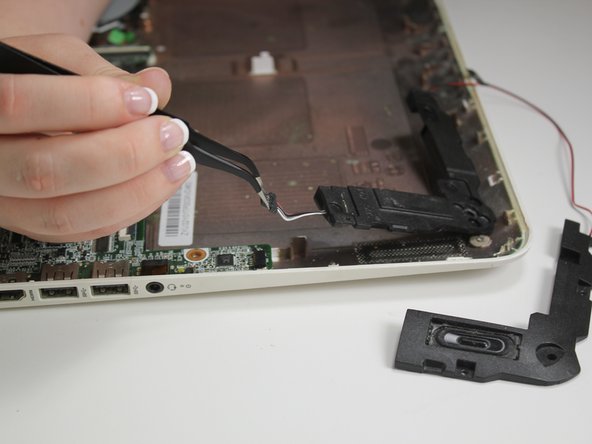

    • Lift the speakers and move them to the side, making sure the wires are not disturbed.
    • To disconnect the cable, use the tip of a spudger or your fingernail to flip up the small locking flap. Then, you can safely pull the cable out.

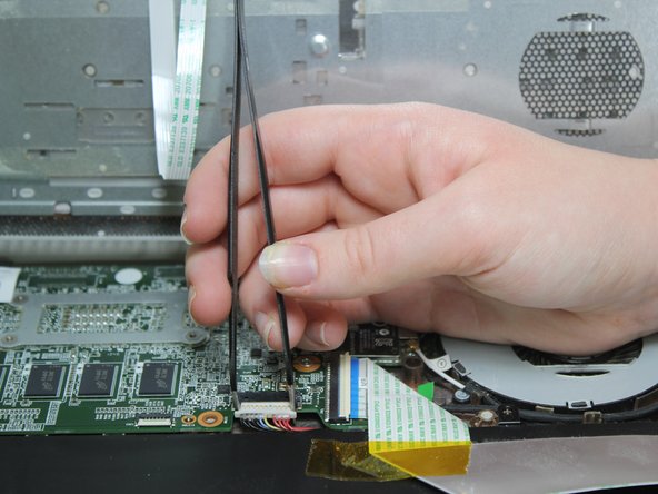

    • Use tweezers to unplug the bundled cable connector from the motherboard.
    • Remove the battery from the laptop.
    • Carefully handle the battery while removing from the device.

    • Use angled tweezers to disconnect the two small bundled cable connectors from the motherboard. Evenly pull individual the cables away from the connector.

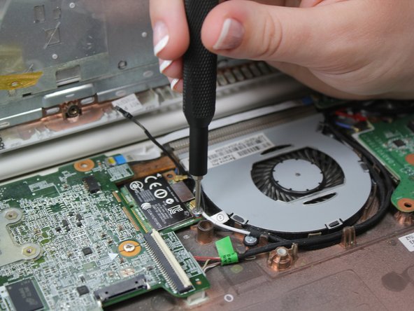

  9. HP Chromebook 14-q063cl Motherboard Replacement: crwdns2935265:09crwdnd2935265:01crwdnd2935265:03crwdne2935265:0 HP Chromebook 14-q063cl Motherboard Replacement: crwdns2935265:09crwdnd2935265:02crwdnd2935265:03crwdne2935265:0 HP Chromebook 14-q063cl Motherboard Replacement: crwdns2935265:09crwdnd2935265:03crwdnd2935265:03crwdne2935265:0

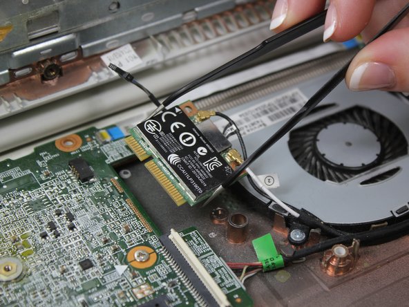

    • Use a Phillips #0 scewdriver to remove one 2.8 mm screw from the Wi-Fi card.
    • Slide the the Wi-Fi card out of the socket with angled tweezers.

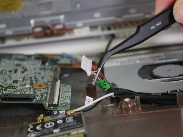

    • Pull the bundled cable away from the connector that attaches the motherboard to the fan.
    • Pull evenly on the full width of the cable so that no individual wires are overly strained.

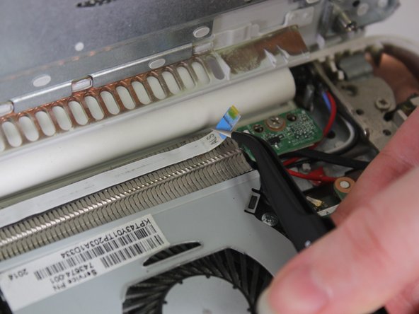

  11. HP Chromebook 14-q063cl Motherboard Replacement: crwdns2935265:011crwdnd2935265:01crwdnd2935265:02crwdne2935265:0 HP Chromebook 14-q063cl Motherboard Replacement: crwdns2935265:011crwdnd2935265:02crwdnd2935265:02crwdne2935265:0

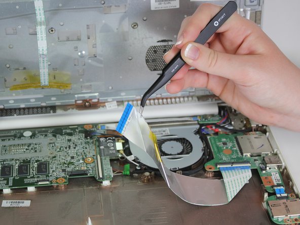

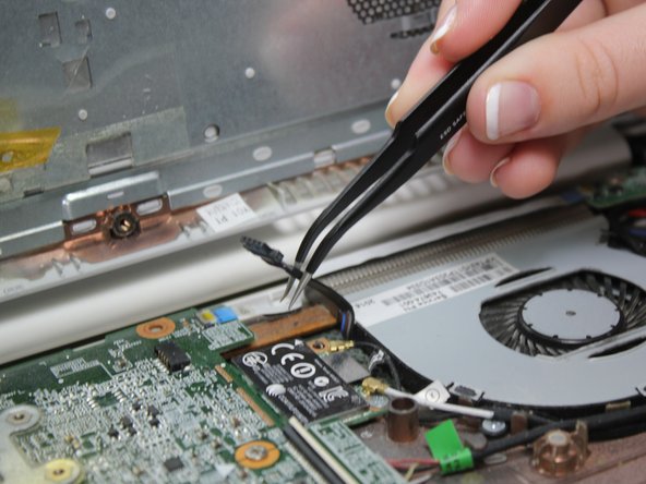

    • Use angled tweezers to disconnect the ribbon cable marked "ALS".

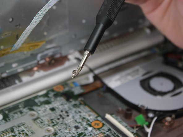

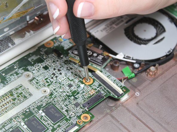

  12. HP Chromebook 14-q063cl Motherboard Replacement: crwdns2935265:012crwdnd2935265:01crwdnd2935265:03crwdne2935265:0 HP Chromebook 14-q063cl Motherboard Replacement: crwdns2935265:012crwdnd2935265:02crwdnd2935265:03crwdne2935265:0 HP Chromebook 14-q063cl Motherboard Replacement: crwdns2935265:012crwdnd2935265:03crwdnd2935265:03crwdne2935265:0
    • Use a Phillips #0 screwdriver to remove four 4.6 mm screws from the motherboard.
    • When putting the new motherboard into the laptop, connect the wifi card to the motherboard before securing it with the screws.

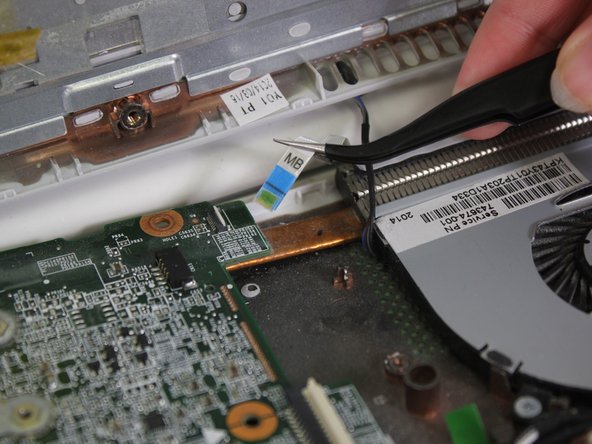

  13. HP Chromebook 14-q063cl Motherboard Replacement: crwdns2935265:013crwdnd2935265:01crwdnd2935265:02crwdne2935265:0 HP Chromebook 14-q063cl Motherboard Replacement: crwdns2935265:013crwdnd2935265:02crwdnd2935265:02crwdne2935265:0
    • Disconnect the ribbon cable with angled tweezers.
    • This connector is not held by a flap lock and can be easily lifted up.
