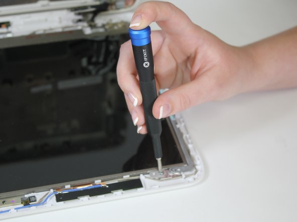

  8. HP Chromebook 14-q063cl Display Screen Replacement: crwdns2935265:08crwdnd2935265:01crwdnd2935265:02crwdne2935265:0 HP Chromebook 14-q063cl Display Screen Replacement: crwdns2935265:08crwdnd2935265:02crwdnd2935265:02crwdne2935265:0
    • Use a Phillips #0 screwdriver to remove four 2.9 mm screws that attach the screen to the top case of the laptop.
    • Do not remove the screws holding down wires as indicated by the orange circles.
