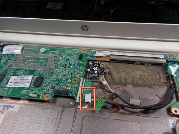

  9. HP Chromebook 14-q029wm Motherboard Replacement, Motherboard: crwdns2935265:09crwdnd2935265:01crwdnd2935265:01crwdne2935265:0
    • Remove the five 2mm Phillips #0 screws from the motherboard.
  10. HP Chromebook 14-q029wm Motherboard Replacement: crwdns2935265:010crwdnd2935265:01crwdnd2935265:01crwdne2935265:0
    • Unclip the black lever holding the connector in place to the motherboard and remove the connector.

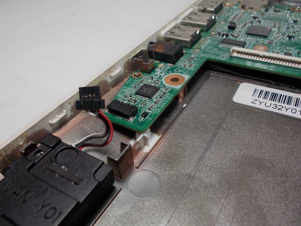

  11. HP Chromebook 14-q029wm Motherboard Replacement: crwdns2935265:011crwdnd2935265:01crwdnd2935265:02crwdne2935265:0 HP Chromebook 14-q029wm Motherboard Replacement: crwdns2935265:011crwdnd2935265:02crwdnd2935265:02crwdne2935265:0
    • Unplug the wire connecting the speaker to the motherboard.
  12. HP Chromebook 14-q029wm Motherboard Replacement: crwdns2935265:012crwdnd2935265:01crwdnd2935265:02crwdne2935265:0 HP Chromebook 14-q029wm Motherboard Replacement: crwdns2935265:012crwdnd2935265:02crwdnd2935265:02crwdne2935265:0
    • Remove this connector found under the right side of the motherboard.

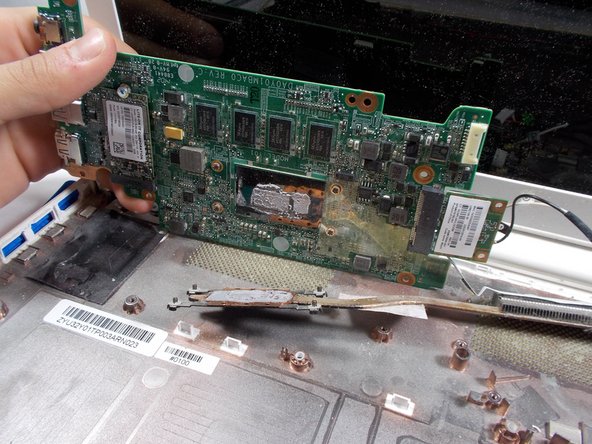

    • Lift the right side of the motherboard slightly and slide the USB and other ports out from the left side.
    • The motherboard should be able to turn on its side after that.

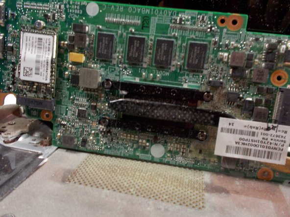

  14. HP Chromebook 14-q029wm Motherboard Replacement: crwdns2935265:014crwdnd2935265:01crwdnd2935265:02crwdne2935265:0 HP Chromebook 14-q029wm Motherboard Replacement: crwdns2935265:014crwdnd2935265:02crwdnd2935265:02crwdne2935265:0
    • Remove the four 2mm Phillips #0 screws from the heat sink.
    • Remove the heat sink from the motherboard.

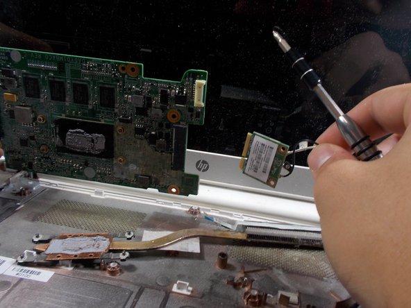

  15. HP Chromebook 14-q029wm Motherboard Replacement: crwdns2935265:015crwdnd2935265:01crwdnd2935265:02crwdne2935265:0 HP Chromebook 14-q029wm Motherboard Replacement: crwdns2935265:015crwdnd2935265:02crwdnd2935265:02crwdne2935265:0
    • Looking at the right side of the motherboard, remove the Wi-Fi card that is connected to the motherboard.
  16. HP Chromebook 14-q029wm Motherboard Replacement: crwdns2935265:016crwdnd2935265:01crwdnd2935265:01crwdne2935265:0
    • Remove the black wire from the screen.
    • Remove the motherboard from the laptop.
