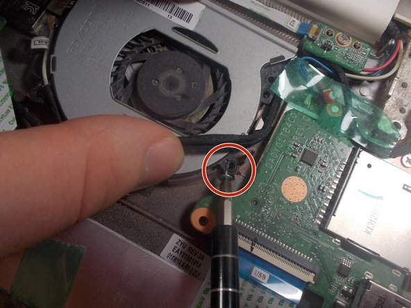

  7. HP Chromebook 14-q029wm Fan Replacement, Fan: crwdns2935265:07crwdnd2935265:01crwdnd2935265:02crwdne2935265:0 HP Chromebook 14-q029wm Fan Replacement, Fan: crwdns2935265:07crwdnd2935265:02crwdnd2935265:02crwdne2935265:0
    • Remove the three 3mm Phillips #0 screws.
    • The bottom right screw may be covered by the fan's wires.
  8. HP Chromebook 14-q029wm Fan Replacement: crwdns2935265:08crwdnd2935265:01crwdnd2935265:01crwdne2935265:0
    • Using your fingers or an opening tool, remove the cable connecting the fan to the motherboard.
    • Gently remove the fan.
