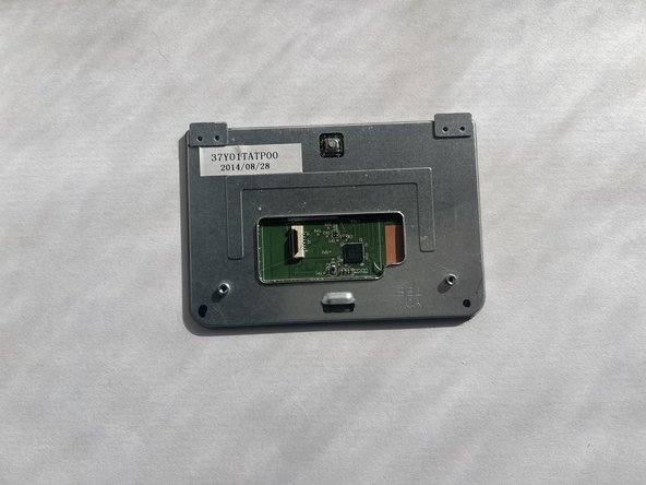

  4. HP Chromebook 14-q010nr Touchpad Replacement, Touchpad: crwdns2935265:04crwdnd2935265:01crwdnd2935265:02crwdne2935265:0 HP Chromebook 14-q010nr Touchpad Replacement, Touchpad: crwdns2935265:04crwdnd2935265:02crwdnd2935265:02crwdne2935265:0
    • Unscrew the two screws securing the touchpad to the keyboard with a Phillips #00 screwdriver.
    • The touchpad may fall out of its position after removing the screws, so carefully remove it with tweezers.
