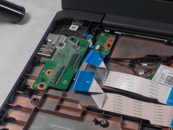

  9. HP Chromebook 14-ca061dx Daughterboard Replacement, Daughterboard: crwdns2935265:09crwdnd2935265:01crwdnd2935265:03crwdne2935265:0 HP Chromebook 14-ca061dx Daughterboard Replacement, Daughterboard: crwdns2935265:09crwdnd2935265:02crwdnd2935265:03crwdne2935265:0 HP Chromebook 14-ca061dx Daughterboard Replacement, Daughterboard: crwdns2935265:09crwdnd2935265:03crwdnd2935265:03crwdne2935265:0
    • Peel back the plastic covering the cables connecting the motherboard to the daughterboard.
    • Use the spudger tool to flip up the black plastic pieces from both cables.
    • Pull both cables toward the right to remove from the daughterboard.
    • Be sure to remove the cables carefully because they are fragile.

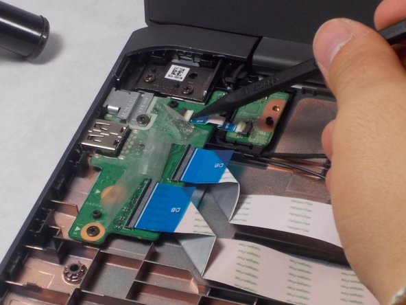

  10. HP Chromebook 14-ca061dx Daughterboard Replacement: crwdns2935265:010crwdnd2935265:01crwdnd2935265:03crwdne2935265:0 HP Chromebook 14-ca061dx Daughterboard Replacement: crwdns2935265:010crwdnd2935265:02crwdnd2935265:03crwdne2935265:0 HP Chromebook 14-ca061dx Daughterboard Replacement: crwdns2935265:010crwdnd2935265:03crwdnd2935265:03crwdne2935265:0
    • Peel back the plastic covering from the smallest blue and white cable.
    • Flip up the white plastic piece using the spudger.
    • Pull the blue cable toward the right to remove it.
    • Be sure to remove the cable carefully because it is fragile.
  11. HP Chromebook 14-ca061dx Daughterboard Replacement: crwdns2935265:011crwdnd2935265:01crwdnd2935265:02crwdne2935265:0 HP Chromebook 14-ca061dx Daughterboard Replacement: crwdns2935265:011crwdnd2935265:02crwdnd2935265:02crwdne2935265:0
    • Remove two 4mm Phillips #0 screws.
    • Remove the daughterboard from the Chromebook.
