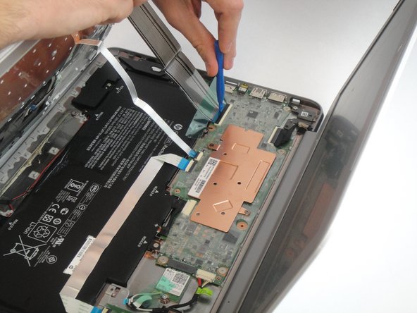

    • Flip the laptop over and open it so the keyboard is visible.
    • Using a plastic opening or prying tool, insert the tool between the keyboard and bottom casing. Then rotate the tool away from the laptop to open it up.
    • Be sure not to pull the keyboard away just yet as the ribbons are still connected.
  3. HP Chromebook 14-ak013dx Charging Port Replacement: crwdns2935265:03crwdnd2935265:01crwdnd2935265:03crwdne2935265:0 HP Chromebook 14-ak013dx Charging Port Replacement: crwdns2935265:03crwdnd2935265:02crwdnd2935265:03crwdne2935265:0 HP Chromebook 14-ak013dx Charging Port Replacement: crwdns2935265:03crwdnd2935265:03crwdnd2935265:03crwdne2935265:0
    • Using a plastic opening tool or your fingers, lift the two black flaps that hold the ribbons connecting the keyboard and touch-pad to fully disconnect the keyboard from the laptop.
    • Disconnect the battery cable from the system board

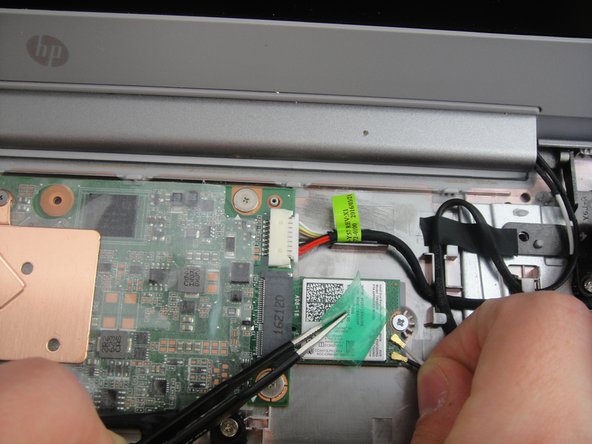

    • Partially remove the tape that is covering the two wires connecting to the wireless adaptor.
    • Disconnect the white and black wires from the adaptor and remove it from the plastic piece used to guide the wire to free up space.
    • The wires are labeled (1) and (2), make note of their position for reassembly

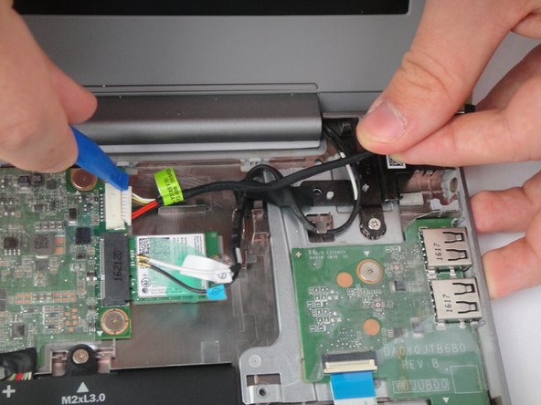

  5. HP Chromebook 14-ak013dx Charging Port Replacement: crwdns2935265:06crwdnd2935265:01crwdnd2935265:03crwdne2935265:0 HP Chromebook 14-ak013dx Charging Port Replacement: crwdns2935265:06crwdnd2935265:02crwdnd2935265:03crwdne2935265:0 HP Chromebook 14-ak013dx Charging Port Replacement: crwdns2935265:06crwdnd2935265:03crwdnd2935265:03crwdne2935265:0
    • Using a prying tool or your fingers, remove the charging port head.
    • Pull by the white plastic or by the wiring away from the connector to remove the piece completely.
    • Replace the broken charging port with a new one.
