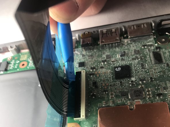

  3. HP Chromebook 14-ak013dx Battery Replacement: crwdns2935265:03crwdnd2935265:01crwdnd2935265:03crwdne2935265:0 HP Chromebook 14-ak013dx Battery Replacement: crwdns2935265:03crwdnd2935265:02crwdnd2935265:03crwdne2935265:0 HP Chromebook 14-ak013dx Battery Replacement: crwdns2935265:03crwdnd2935265:03crwdnd2935265:03crwdne2935265:0
    • Remove both ribbon cables attaching the separated keyboard to the motherboard.
    • The large black ribbon cable was a tab that should be pried open to loosen the ribbon from its hub. Use the plastic opening tool as shown.
    • Gently pull out the short white ribbon cable out of its hub.

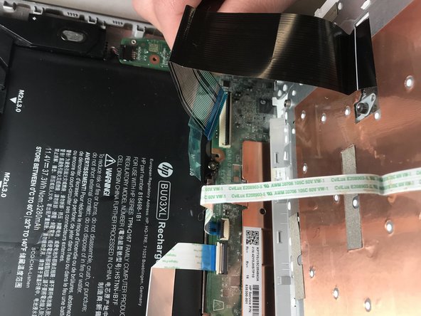

  4. HP Chromebook 14-ak013dx Battery Replacement: crwdns2935265:04crwdnd2935265:01crwdnd2935265:02crwdne2935265:0 HP Chromebook 14-ak013dx Battery Replacement: crwdns2935265:04crwdnd2935265:02crwdnd2935265:02crwdne2935265:0
    • Peel up the adhered ribbon cable. This cable does not need to be detached from the motherboard.
    • Use a plastic opening tool to disconnect the battery before going any further by inserting the tool between the plug and the hub where the recesses are on either side of the plug.
  5. HP Chromebook 14-ak013dx Battery Replacement: crwdns2935265:05crwdnd2935265:01crwdnd2935265:02crwdne2935265:0 HP Chromebook 14-ak013dx Battery Replacement: crwdns2935265:05crwdnd2935265:02crwdnd2935265:02crwdne2935265:0
    • Unscrew the four M2xL3 screws , shown in the picture, using a Phillips screwdriver.
    • Carefully lift the battery out of its place, avoiding the previously adhered silver ribbon cable in the process.
