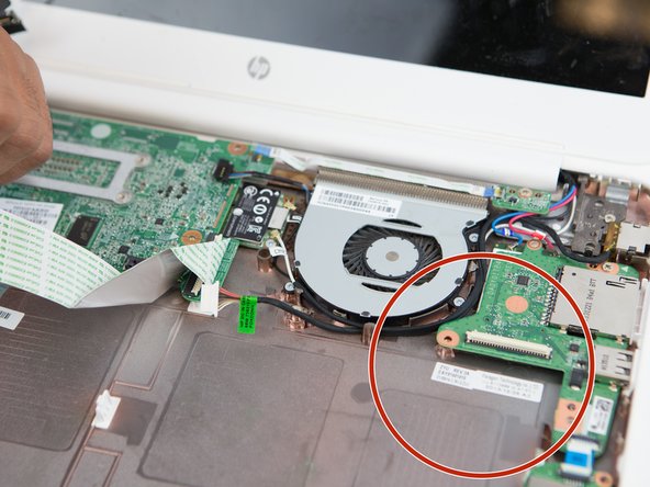

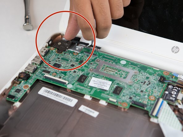

    • Use the Phillips #1 screwdriver to remove the (5) five screws.
  10. HP Chromebook 14-Q070NR Solid State Drive Replacement: crwdns2935265:010crwdnd2935265:01crwdnd2935265:02crwdne2935265:0 HP Chromebook 14-Q070NR Solid State Drive Replacement: crwdns2935265:010crwdnd2935265:02crwdnd2935265:02crwdne2935265:0
    • Use the blue plastic opening tool to disconnect the connectors. Remove the fan from the motherboard.
  11. HP Chromebook 14-Q070NR Solid State Drive Replacement: crwdns2935265:011crwdnd2935265:01crwdnd2935265:02crwdne2935265:0 HP Chromebook 14-Q070NR Solid State Drive Replacement: crwdns2935265:011crwdnd2935265:02crwdnd2935265:02crwdne2935265:0

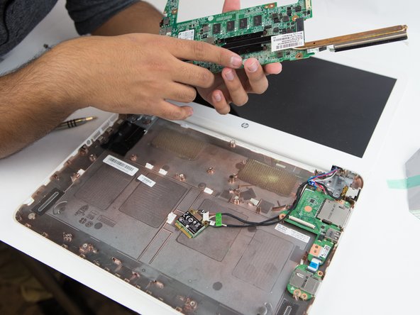

    • Gently lift while using the plastic opening tool to unhinge the motherboard from the computer in an upward pattern.
    • Be very careful not to detach the motherboard to quickly or forcefully since you could damage or break it.
