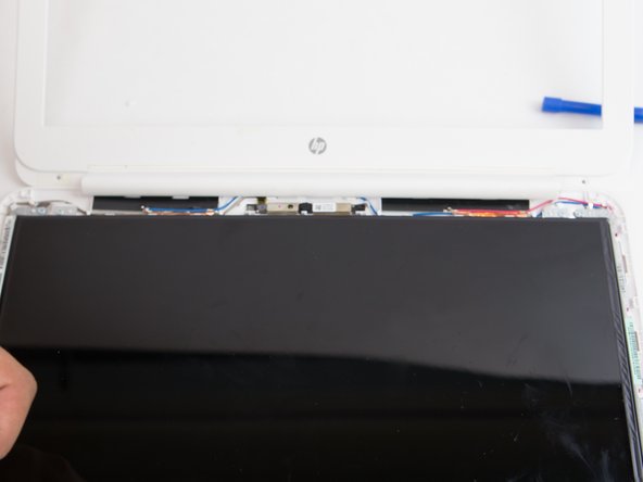

  7. HP Chromebook 14-Q070NR Display Replacement: crwdns2935265:07crwdnd2935265:01crwdnd2935265:01crwdne2935265:0
    • Insert the plastic opening tool and work it around the entire frame of the display.
  8. HP Chromebook 14-Q070NR Display Replacement: crwdns2935265:08crwdnd2935265:01crwdnd2935265:02crwdne2935265:0 HP Chromebook 14-Q070NR Display Replacement: crwdns2935265:08crwdnd2935265:02crwdnd2935265:02crwdne2935265:0
    • As you work the plastic opening tool around the edge, remove the front frame of the device.

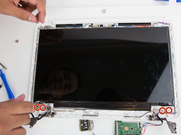

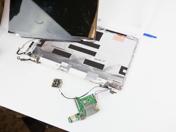

  9. HP Chromebook 14-Q070NR Display Replacement: crwdns2935265:09crwdnd2935265:01crwdnd2935265:03crwdne2935265:0 HP Chromebook 14-Q070NR Display Replacement: crwdns2935265:09crwdnd2935265:02crwdnd2935265:03crwdne2935265:0 HP Chromebook 14-Q070NR Display Replacement: crwdns2935265:09crwdnd2935265:03crwdnd2935265:03crwdne2935265:0
    • Using the Phillips #1 screwdriver, remove the (4) four screws located at the bottom of the display.
    • Once the screws are removed, lift the display out of the device.
