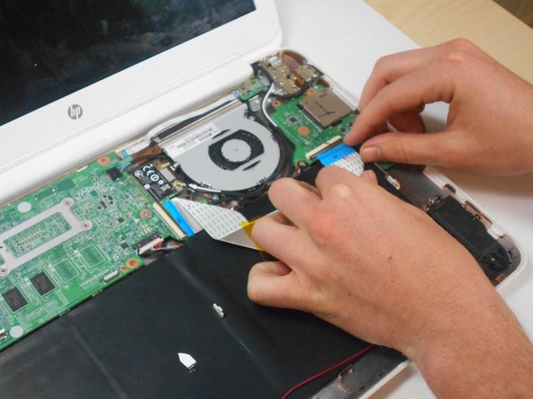

  3. HP Chromebook 14-Q010DX Hard drive Replacement: crwdns2935265:03crwdnd2935265:01crwdnd2935265:03crwdne2935265:0 HP Chromebook 14-Q010DX Hard drive Replacement: crwdns2935265:03crwdnd2935265:02crwdnd2935265:03crwdne2935265:0 HP Chromebook 14-Q010DX Hard drive Replacement: crwdns2935265:03crwdnd2935265:03crwdnd2935265:03crwdne2935265:0
    • Warning! Handle the flaps and ribbon cables with care to prevent damage.
    • Gently pull the keyboard in the opposite direction of the screen, so the wires beneath are exposed.
    • Lift the black flap and pull the blue ribbon gently towards you until it is disconnected.
    • Lift the white flap and pull the blue ribbon towards you until it is disconnected.

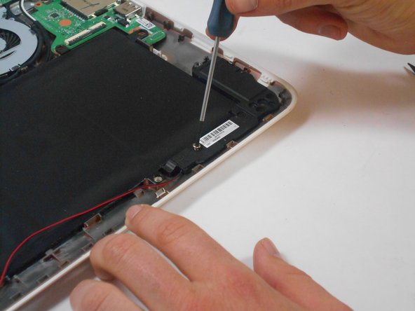

  6. HP Chromebook 14-Q010DX Hard drive Replacement, Speaker: crwdns2935265:06crwdnd2935265:01crwdnd2935265:03crwdne2935265:0 HP Chromebook 14-Q010DX Hard drive Replacement, Speaker: crwdns2935265:06crwdnd2935265:02crwdnd2935265:03crwdne2935265:0 HP Chromebook 14-Q010DX Hard drive Replacement, Speaker: crwdns2935265:06crwdnd2935265:03crwdnd2935265:03crwdne2935265:0
    • Undo the black tape located on the bottom from the frame of the laptop.
    • The tape has no function other than to keep the wire tucked away.
    • Using fingers or the spudger, slide out the black connector indicated on the left.
    • Use a #00 screwdriver to remove the two screws.
  7. HP Chromebook 14-Q010DX Hard drive Replacement: crwdns2935265:07crwdnd2935265:01crwdnd2935265:02crwdne2935265:0 HP Chromebook 14-Q010DX Hard drive Replacement: crwdns2935265:07crwdnd2935265:02crwdnd2935265:02crwdne2935265:0
    • Gently remove the speakers.

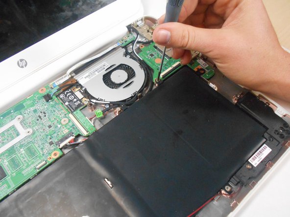

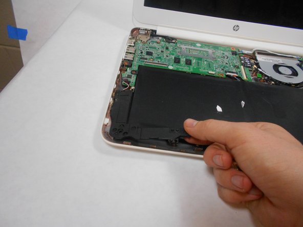

  9. HP Chromebook 14-Q010DX Hard drive Replacement: crwdns2935265:09crwdnd2935265:01crwdnd2935265:03crwdne2935265:0 HP Chromebook 14-Q010DX Hard drive Replacement: crwdns2935265:09crwdnd2935265:02crwdnd2935265:03crwdne2935265:0 HP Chromebook 14-Q010DX Hard drive Replacement: crwdns2935265:09crwdnd2935265:03crwdnd2935265:03crwdne2935265:0
    • Remove the screw.
    • Use your fingers to pull the white tab out of the black slot above the battery.
  10. HP Chromebook 14-Q010DX Hard drive Replacement: crwdns2935265:010crwdnd2935265:01crwdnd2935265:01crwdne2935265:0
    • Gently remove battery.

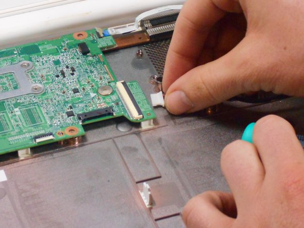

  11. HP Chromebook 14-Q010DX Hard drive Replacement, Bluetooth and Wireless Card: crwdns2935265:011crwdnd2935265:01crwdnd2935265:02crwdne2935265:0 HP Chromebook 14-Q010DX Hard drive Replacement, Bluetooth and Wireless Card: crwdns2935265:011crwdnd2935265:02crwdnd2935265:02crwdne2935265:0
    • Using a spudger, remove the white and black cables from the card.
  12. HP Chromebook 14-Q010DX Hard drive Replacement: crwdns2935265:012crwdnd2935265:01crwdnd2935265:02crwdne2935265:0 HP Chromebook 14-Q010DX Hard drive Replacement: crwdns2935265:012crwdnd2935265:02crwdnd2935265:02crwdne2935265:0
    • Remove screw from card.
  13. HP Chromebook 14-Q010DX Hard drive Replacement: crwdns2935265:013crwdnd2935265:01crwdnd2935265:01crwdne2935265:0
    • Gently pull card at a 45° angle to remove it.

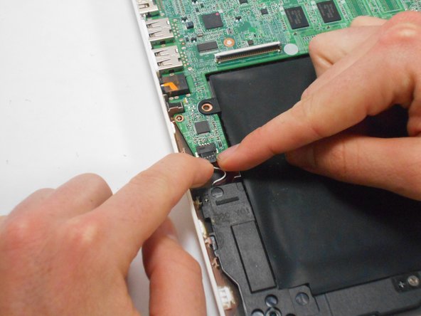

  18. HP Chromebook 14-Q010DX Hard drive Replacement, Motherboard: crwdns2935265:018crwdnd2935265:01crwdnd2935265:02crwdne2935265:0 HP Chromebook 14-Q010DX Hard drive Replacement, Motherboard: crwdns2935265:018crwdnd2935265:02crwdnd2935265:02crwdne2935265:0
    • Using your fingers or spudger, pull out the connector.
  19. HP Chromebook 14-Q010DX Hard drive Replacement: crwdns2935265:019crwdnd2935265:01crwdnd2935265:03crwdne2935265:0 HP Chromebook 14-Q010DX Hard drive Replacement: crwdns2935265:019crwdnd2935265:02crwdnd2935265:03crwdne2935265:0 HP Chromebook 14-Q010DX Hard drive Replacement: crwdns2935265:019crwdnd2935265:03crwdnd2935265:03crwdne2935265:0
    • Remove all of the indicated screws.
    • Pull up on black strip to remove the monitor cord.

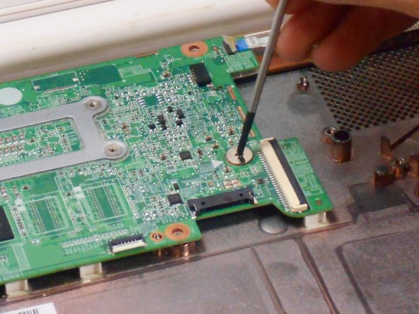

  21. HP Chromebook 14-Q010DX Hard drive Replacement, Hard drive: crwdns2935265:021crwdnd2935265:01crwdnd2935265:01crwdne2935265:0
    • Flip motherboard over.
  22. HP Chromebook 14-Q010DX Hard drive Replacement: crwdns2935265:022crwdnd2935265:01crwdnd2935265:01crwdne2935265:0
    • Remove the screw indicated by the red circle.
  23. HP Chromebook 14-Q010DX Hard drive Replacement: crwdns2935265:023crwdnd2935265:01crwdnd2935265:01crwdne2935265:0
    • Remove the hard drive by pulling the device from the black slot.
