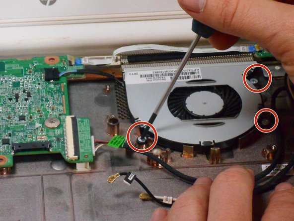

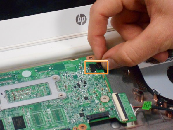

    1. HP Chromebook 14-Q010DX Fan Replacement, Fan replacement for a HP Chromebook: crwdns2935265:06crwdnd2935265:01crwdnd2935265:03crwdne2935265:0 HP Chromebook 14-Q010DX Fan Replacement, Fan replacement for a HP Chromebook: crwdns2935265:06crwdnd2935265:02crwdnd2935265:03crwdne2935265:0 HP Chromebook 14-Q010DX Fan Replacement, Fan replacement for a HP Chromebook: crwdns2935265:06crwdnd2935265:03crwdnd2935265:03crwdne2935265:0
      • Remove the 3 screws around the fan.
      • Using your fingers or the spudger, disconnect the cable connecting the fan to the motherboard.
    2. HP Chromebook 14-Q010DX Fan Replacement: crwdns2935265:07crwdnd2935265:01crwdnd2935265:01crwdne2935265:0
      • Once the cable connecting the fan to the motherboard is revomed gently remove fan with hands.
